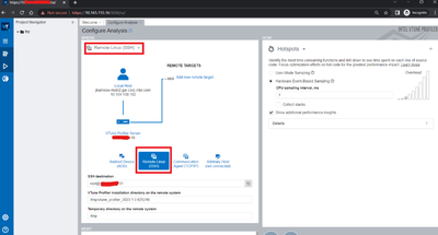

Let me explain what @Rahila_T_Intel is trying to say. Basically, you are using the below method and deploying agent as shown in the below screenshot.
There are some issues with the above process, so the workaround she gave was running Vtune via remote ssh. The command line command I gave above is ntg, but remote Linux ssh (-target-system)
If you do password-less ssh perfectly, you can click on deploy and start analysis as shown in the below screenshot.
This above process is similar to the below command, but you are running it in a GUI:
vtune -target-system ssh:root@<Target name> -target-install-dir=/tmp/vtune_profiler -collect hotspots -app-working-dir /usr/bin <Path to the application in the Target container>
Another method is running above command via terminal and view/open results on vtune GUI.
If this workaround works, you can accept @Rahila_T_Intel post as a solution so that can help others with similar issue. Thank you.
