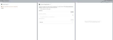

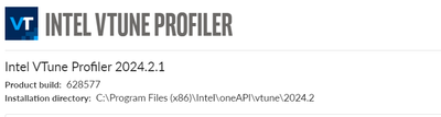

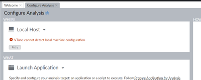

unfortunately I run into issues starting vtune. I use the latest oneAPI (20242.2.1)
No matter if I run vtune from vs2022 or from command line I do get this error. running on windows 11 with all updates.
Any idea what I'm doing wrong here?

Just noticed: advisor didn't start at all from VS2022 (EXTENSIONS->Intel->Analyze performance with Intel Advisor).

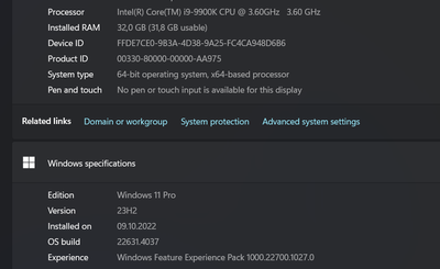

The CPU is 9th Gen Intel® Core™ processor?  If yes, you can try it below.
https://www.intel.com/content/www/us/en/download/19344/intel-graphics-windows-dch-drivers.html

Not able to select any type of analysis - seems to required host config check first:
Daniel_D
12,033 Views
Can I try something else to get vtune working? Start from commandline gives the same error message:
VTune cannot detect local machine configuration.

From the current analysis, it looks like something is wrong with the environment setup that impacts VTune usage. Did VTune work on the same machine before the 2024.2.1 release?
By the way, can you share the Windows OS version and build number here?
