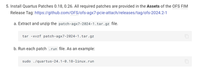

First thing I noticed is that your Quartus is missing 2 patches which I suspect might be the cause of it since I'm comparing the logs between mine and yours and saw some process are missing.
log:
Do install the patches
https://github.com/OFS/ofs-agx7-pcie-attach/releases/tag/ofs-2024.2-1
You should get 0.02iofs , 0.18 and 0.26 patches when you check the version "quartus_sh --version"
Could you download and install those patches first and rerun the FIM generation?

I completed the patch installation of IOFS based on your previous reply and have started the FIM generation. However, I'm still facing some errors during compilation. I’ve attached the logs for your reference.
