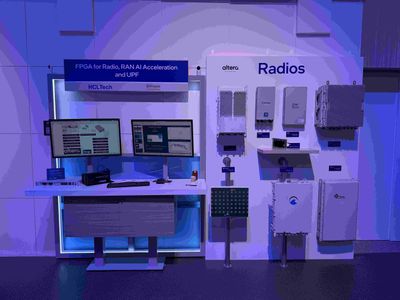

A Wall of Radios: Showcasing Versatility and Innovation
One of the highlights of our exhibit was Altera’s Wall of Radios, featuring eight models from our partners and customers—Syntronic, Tejas Networks, Massive Beams, Radisys, Intel, Comba, and BMI. Each radio was powered by Altera FPGAs, and many demonstrated the ease of deployment and fast time-to-market made possible by our Radio Enablement Packages. These solutions catered to a wide range of applications, from Small Cell and Macro to mMIMO, offering our customers unparalleled flexibility and performance in radio deployments.

Figure 2.  Altera Wall of Radios at MWC 2025
