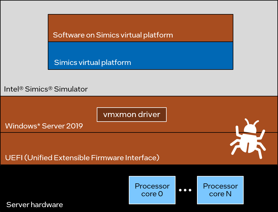

“One factor that differentiates kernel development from user-space development is the hardship associated with debugging. It is difficult, relative to user-space, to debug the kernel.” – Robert Love, Linux Kernel Development, Third Edition.
This is story of a single line of code that took nine months to write. The story began in early 2020 with a couple of bug reports complaining about Windows* host crashes when running the Intel® Simics® Simulator. The reports indicated that the simulations were running on servers using the Microsoft* Windows* Server 2019 operating system. It appeared that similar hardware running Windows Server 2016 did not suffer problems. However, over time similar reports did start to appear for hosts running older Windows versions as well as Linux*.
Thus, it was clear that there was a rare but repeatable issue where running Simics virtual platforms caused system crashes. The crashes happened when the virtual platform used virtualization to speed up the execution of target system code. When replicating the conditions causing the bug in the development lab, the bug was found to trigger about once per day on average (with the Simics Simulator running non-stop on a dedicated replication host). Note that “on average” means that some days the crash could happen multiple times, other days not at all.
This is the story of what happened, and how the bug was found and resolved. The bug was in low-level code that is very hard to debug on hardware. However, debugging was possible by running the Simics Simulator on top of the Simics Simulator.

To explain what was going on, let us start with some background information. At core, the Simics Simulator runs target system instructions using a mix of an interpreter, a just-in-time (JIT) compiler, and virtualization. Virtualization is used when simulating Intel architecture targets on Intel architecture hosts, allowing simulations to run much faster than when using a JIT compiler.
To use virtualization, the Simics simulator relies on a custom driver known as vmxmon, as shown in the following picture:
In effect, vmxmon works as a virtual machine monitor (VMM), similar to other hypervisor or virtual machine software vmxmon itself runs in what is known as VMX root mode–the hypervisor mode–while guest or target software (the code running on the simulated system) runs in VMX non-root mode.
The processor behavior in VMX non-root mode is restricted and modified to facilitate virtualization. Certain instructions and events cause virtual machine (VM) exits, transitioning back to the VMM. The VMM uses a virtual machine control structure (VMCS) to manage guest software running in VMX non-root mode. This allows the VMM to retain control of the host, even if the guest software is running operating-system code. See “Intel® 64 and IA-32 Architectures Software Developer’s Manual” for more details.

Running the Bug inside of the Simics Simulator
To move forward, better debug abilities were needed than what hardware provided. This is achieved by running the Simics Simulator inside the Simics Simulator itself. Initially, a setup was used that was as close as possible to the hardware setup.
This meant using a server platform model running the same UEFI as the real hardware and configured with the same number of cores as the hardware. Since the host operating system had been proven not to matter, Ubuntu* Linux 20.04 was installed on the target system instead of Windows. The Simics Quick-Start Platform (QSP) was used in the target setup, since it provides a lightweight Intel Architecture target.
The setup looks like this:
It took less than a working day to prepare the setup and trigger the reproducer of the issue.
Reproducing the setup inside of the Simics Simulator made it possible to check what was actually going on. Once the crash happened inside the simulation target system, it was easy to find the processor core that was in SMM mode, and then investigate what it was doing. The command-line session below shows how this was done:

The complete observed flow is shown below. Starting in VMX root mode, the execution moves into VMX non-root mode (VM-entry), followed by an SMI getting into SMM, and finally a #DB exception leading to the infinite loop. The remaining question was why the SMM handler caused the #DB exception.
The simulator log message indicates that the exception was generated because the code attempted to read the register DR7 (instruction number 35347272) when DR7.GD (bit 13, general detect enable) was set. This bit enables debug-register protection, making the processor raise a debug exception when MOV instructions access a debug register. Looking back through the trace, the SMM handler reads the value of the DR7 register from the SMM save area (instruction number 78). The value is 0x2400 and GD bit is set. The value is then written (without modification) to the DR7 register (instruction number 81), enabling debug register protection.
Later, the SMM handler tries to read the DR7 register, without checking whether this is indeed allowed in the current processor state. This read causes the debug exception and jump to the infinite loop. The SMM handler code simply assumed that the DR7.GD bit was not set.
The DR7 value used in VMX non-root mode is determined by the VMCS structure, which is in turn managed by the vmxmon driver. The purpose of setting the DR7.GD bit was to intercept all accesses to debug registers, as that is necessary to provide correct results for the target code running on top the simulator. However, the same result can be achieved via the “MOV-DR exiting” VM-execution control setting.
Thus, updating the vmxmon driver not to set the DR7.GD bit and use the alternative mechanism avoids the buggy scenario.  This increases the reliability of the Simics Simulator regardless of the software and hardware that it is running on. If the SMM handler in one UEFI exhibits this behavior, it is possible that others do too.
