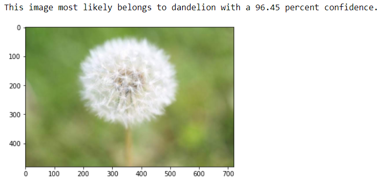

To set the baseline, launch the existing notebook with a sample from flowers dataset and run inference.
# Pre-process the image and get it ready for inference
inp_img_url =
"https://upload.wikimedia.org/wikipedia/commons/4/48/A_Close_Up_Photo_of_a_Dandelion.jpg"
file_path = Path("output")/Path("A_Close_Up_Photo_of_a_Dandelion.jpg")
input_image = pre_process_image(file_path)
# Run inference on the input image
res = compiled_model([input_image])[output_layer]
score = tf.nn.softmax(res[0])
# Show the results
image = Image.open(file_path)
plt.imshow(image)
print(
"This image most likely belongs to {} with a {:.2f} percent confidence."
.format(class_names[np.argmax(score)], 100 * np.max(score))
Here is the classification result for this sample image of a flower:
