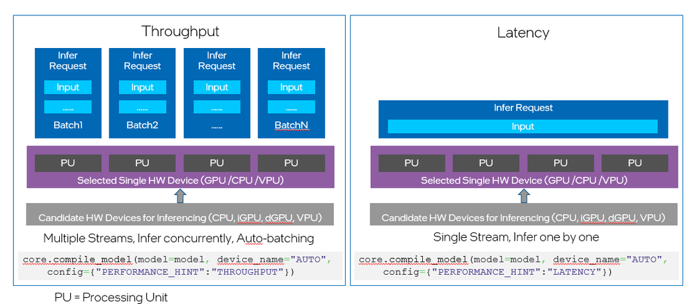

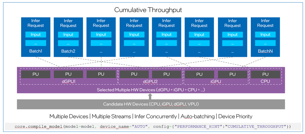

While the two performance hints in AUTO, LATENCY and THROUGHPUT, available from OpenVINO™ 2022.1, can select one target device with your preferred performance option (as shown in Fig.1), the CUMULATIVE_THROUGHPUT option enables running inference on multiple devices for higher throughput. With CUMULATIVE_THROUGHPUT, AUTO loads the network model to all available devices in the candidate list, and then runs inference on them based on the default or specified priority, as shown in Fig.2.
Fig.1. Hardware selection and inference requests in “Throughput” and “Latency”Fig.1. Hardware selection and inference requests in “Throughput” and “Latency”
Fig.2. Hardware selection and inference request in “CUMULATIVE_THROUGHPUT”Fig.2. Hardware selection and inference request in “CUMULATIVE_THROUGHPUT”
