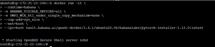

Start docker
Make sure to use the latest PyTorch container from here.
docker pull vault.habana.ai/gaudi-docker/1.6.1/ubuntu20.04/habanalabs/pytorch-installer-1.12.0:latest
docker run -it \
--runtime=habana \
-e HABANA_VISIBLE_DEVICES=all \
-e OMPI_MCA_btl_vader_single_copy_mechanism=none \
--cap-add=sys_nice \
--net=host \
--ipc=host vault.habana.ai/gaudi-docker/1.6.1/ubuntu20.04/habanalabs/pytorch-installer-1.12.0:latest
