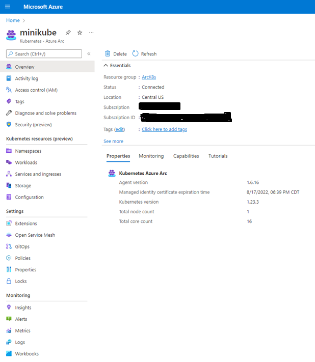

On the Azure portal, the minkube Kubernetes deployment (single node cluster) can be managed under the created resource group “ArcK8s” as shown in screenshot figures below.
Figure 4: On Premise minkube Kubernetes managed in Azure PortalFigure 4: On Premise minkube Kubernetes managed in Azure Portal
Figure 5: On Premise minkube Kubernetes cluster resources in Azure PortalFigure 5: On Premise minkube Kubernetes cluster resources in Azure Portal
