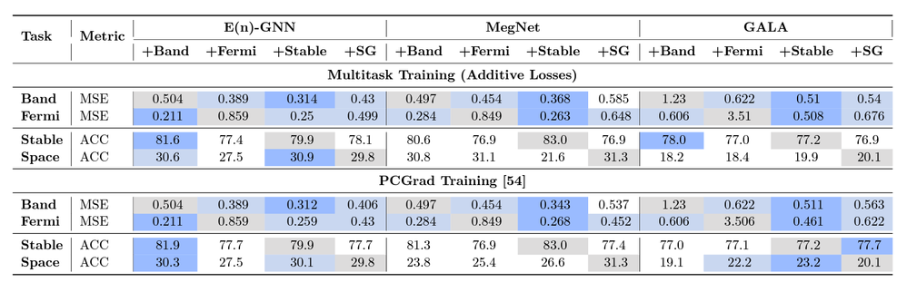

Table 2. Benchmark results on materials project multi-task learning. Shown are the best performing (highlighted in dark blue) along with single-task baseline (highlighted in gray) with each multi-task run outperforming the single-task baseline (highlighted in light blue). Multi-task learning generally outperforms single task on regression tasks with only small performance difference between additive losses and PCGrad, a state-of-the-art multi-task learning method.
In our research study using MatSci ML, models are trained in multi-task (using one model to predict multiple targets) and multi-data (using one model to predict the same task from multiple datasets) training settings. As shown in Tables 2 and 3, training on multiple related tasks tends to improve model performance, illustrating the value of additional information. This holds for multiple multi-task methods, vanilla multi-task as well as PCGrad, which minimizes conflicts between tasks.
