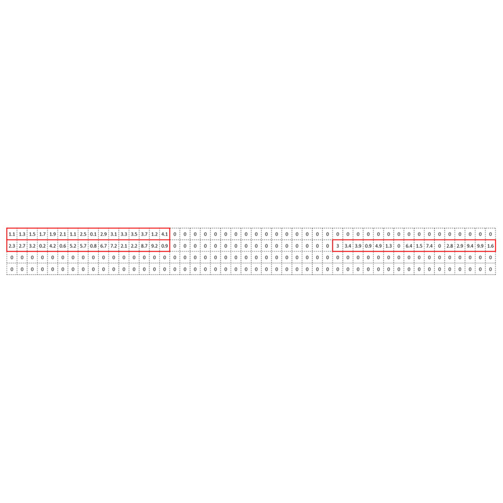

Sparsity is a promising technique to reduce the computation and memory footprints in deep learning optimization. In our open submission [5], we explored structured sparsity optimization by using training for sparsity. We demonstrated the success of FP32 sparse optimization on DLRM.
We proposed a 16x1 sparsity pattern to take advantage of the Intel® Advanced Vector Extensions (Intel AVX-512 architecture. For this blog, we call this sparsity pattern a tile-based sparsity. Tile-based sparsity consists of blocks of non-zeros in some regular pattern. Figure 1 shows an example with the tiles of consecutive 16 non-zero elements in red boxes, while the rest of the tiles are zeros.
perf gains
Figure 1. Tile-based sparsity (16x1 sparsity pattern) after training with sparsity in FP32
With training for sparsity and magnitude-based pruning, we generated a sparse model for DLRM with a geometric mean (geomean) of 80 percent. The model has up to a 99 percent sparsity ratio for the General Matrix Multiplications (GEMMs). We developed the sparse GEMM kernel and verified both accuracy and performance using the MLPerf test software. With sparse GEMMs, we achieved 1.4X inference speedup [6] on 3rd Gen Intel Xeon Scalable processors compared to the same software with the original dense GEMMs, while keeping the accuracy loss within 1 percent, as shown in Table 1.

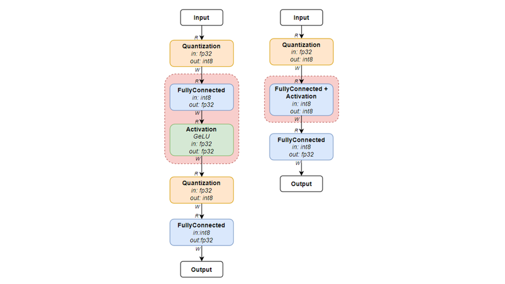

The BERT model is widely used for NLP pretraining. The model itself has many repeated FullyConnected + Activation sub-graphs, so optimizing these repeated sub-graphs gives a significant boost to overall inference performance. Figure 2 shows the BERT pattern of FullyConnected + GeLU activation function that we fuse together.
perf gains
Figure 2. Operator Fusion on BERT Sub-graph Before (left) and After (right) Fusion. (R = Read, W = Write)
Comparing the before and after fusion in the dashed box in Figure 2 for one sub-graph, we can reduce the number of memory accesses in the dashed red box for activations from 4 to 2.  The tensor output from FullyConnected can go into Activation directly, without going to the memory, while the output from the activation then gets stored in memory. The fusion also reduces the quantization steps from 2 to 1 in Figure 2. This results in two fewer reads and writes to the memory. The left row has ten reads and writes in the five blocks, while we have six reads and writes in the three blocks on the right. In this example, we reduced memory reads and writes by 40 percent [7] in the subgraph with the operator fusions.

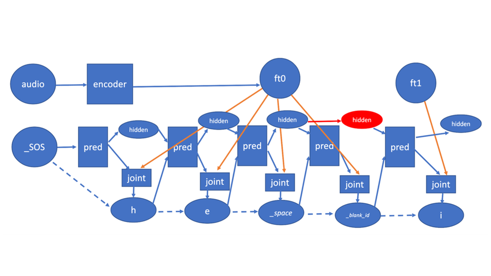

The reference RNN-T implementation has a sequential decoder. The encoded audio sequence is decoded token-by-token through the greedy decoder. To improve the compute efficiency, we introduce a batch greedy decoder and vectorize most of the decoder steps with PyTorch tensor operations.
Compared to its sequential version, a batch greedy decoder takes a vector of ‘feature front’ (as shown in Figure 4) from the encoder output. It uses each vector as the input to the joint network. In the example in Figure 4, we have several scenarios at each time step. In this example, we can decode the same vector [f00, f10]. We can advance the second value when we get the _blank_id token in the second row [f00, f11]. Or we can advance the first value when we get the _blank_id token in the first row [f01, f11].
perf gains
Figure 3. Sequential Greedy Decoder with 'ft0' and 'ft1' Being Decoded in Sequence

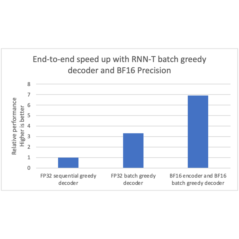

In our experiments, batch greedy decoder improves RNN-T offline throughput by 3.3X compared to sequential greedy decoder. Converting to BF16 precision brings another 2.1X improvement.  The total improvement over the starting model with the sequential decoder is 6.9X [9], as shown in Figure 5.
perf gains
Figure 5. RNN-T Offline Throughput Improvement Breakdown [9]

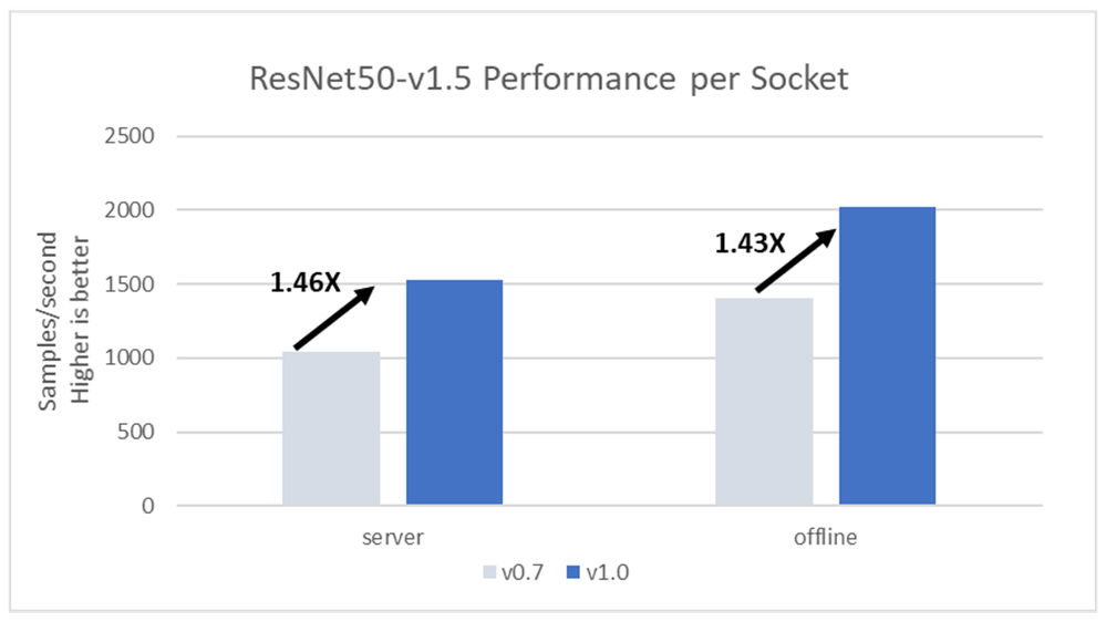

We continue to deliver more compute and memory bandwidth with our new 3rd Gen Intel Xeon Scalable processors. We saw up to 46 percent (v0.7: [1] v1.0: [2]) more performance per socket compared to our MLPerf v0.7 submission with 2nd Gen Intel Xeon Scalable processors (code name: Cascade Lake).
perf gains
Figure 6. ResNet50-v1.5 Performance Improvement from MLPerf v0.7[1] to v1.0[2].

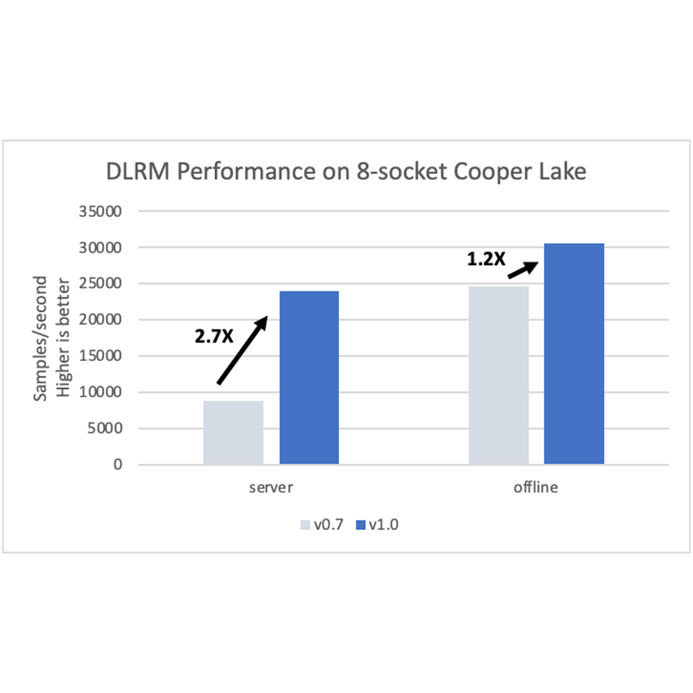

With software optimizations, DLRM benchmarks in MLPerf v1.0 improved by up to 2.7X compared to our v0.7 submission on the same CPU platform (v0.7: [3] v1.0: [4]). (See Figure 7.)
perf gains
Figure 7. DLRM Performance Improvement from MLPerf v0.7[3] to v1.0[4].
