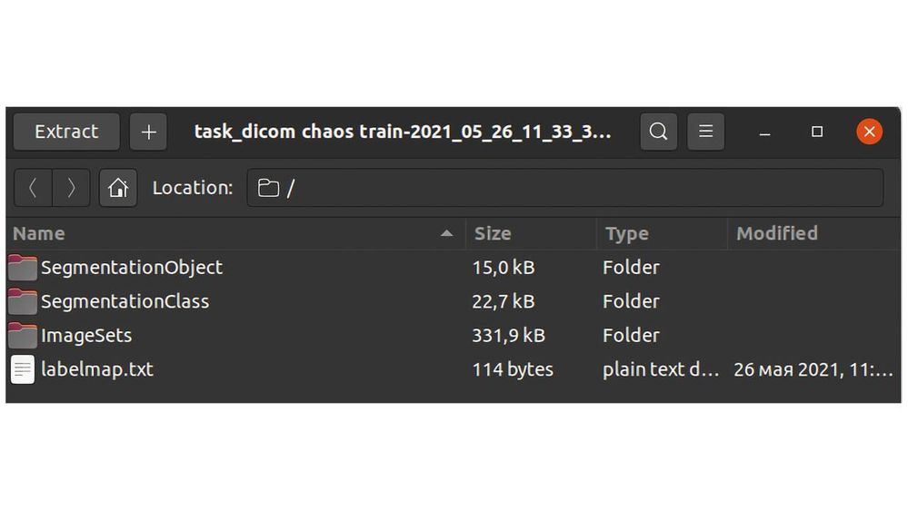

Finally, when our data are annotated, we can get results as PNG masks for example. Actually, CVAT supports a huge number of different formats, but IMHO masks are quite popular when working with DICOM data.
figure 6
The final file contains masks and other useful information:
figure 7
figure 8
