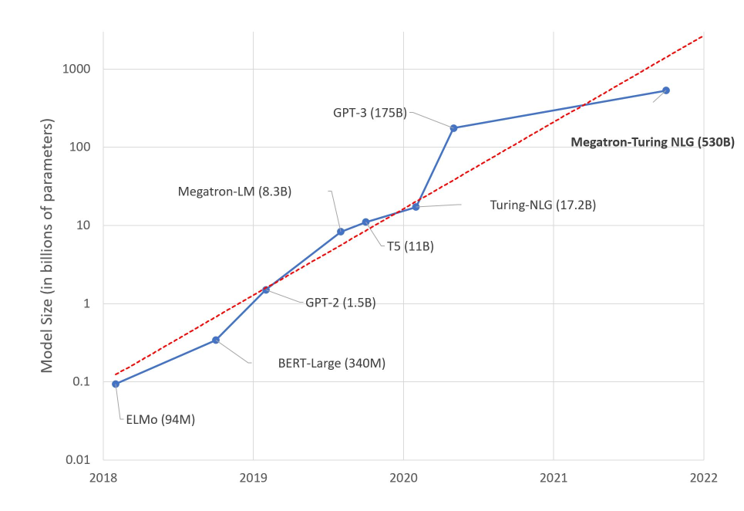

Large Language Models (LLMs) are becoming super large, with model sizes growing by 10x in only a few years as shown in Figure 1 [7]. Increase in model sizes offers considerable gains in model accuracy. Large LLMs such as GPT-2 (1.5B), Megatron-LM (8.3B), T5 (11B), Turing-NLG (17B), Chinchilla (70B), GPT-3 (175B), OPT-175B, BLOOM (176B), etc. have been released to excel in various tasks such as natural language understanding, question answering, summarization, translation, and natural language generation.  As the size of LLMs keeps growing, how can we efficiently train such large models?  Of course, the answer is “parallelization”
trend-of-sizes-nlp-models
Figure 1 – Trend of sizes of state-of-the-art NLP models over time [7]
