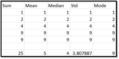

Some examples would be computing a sum, an average, the median, the standard deviation, or the mode of a column or row of data, as seen in the table below:
Table 1: Examples of common aggregations

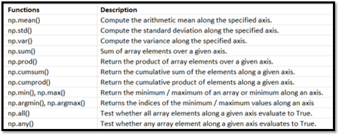

Below is a table of aggregations commonly used in machine learning:
table2.pngtable2.pngTable 2: UFuncs commonly used in machine learning

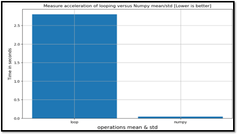

As you can see, the NumPy code is much more readable ( 3 lines of code versus 16 lines), more maintainable, and it is faster too. The timing comparison is as follows ‘naive loop’: 2.8 seconds, NumPy mean/std: .04 seconds. This is a speedup over the naive code by a factor of over 60X.
chart1.pngchart1.pngChart 1: speedup of NumPy mean/std code over my naive Python implementation

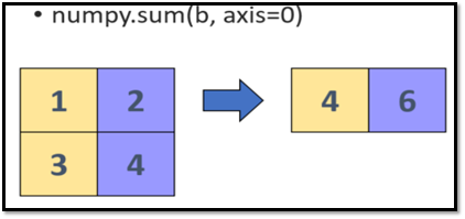

Another aspect of many NumPy aggregations/reductions is the ability to specify an axis over which to apply the reducing function. As an example, consider the NumPy sum() function. Without an axis specifier it adds ALL the values in an N dimensions array to arrive at a scalar value. In the example below I specify axis=0, it returns a row vector that sums each column of the matrix.
example1.pngexample1.pngExample 1: Summing on axis = 0

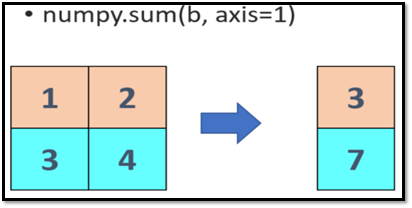

Alternatively, if I specify axis=1, I get a column vector whose entries are the sums of each row.
example2.pngexample2.pngExample 2: Summing on axis = 108_03_NumPy_Aggregations.ipynb
