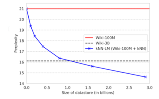

 Figure 1 – kNN-LM: Effect of datastore size on perplexities

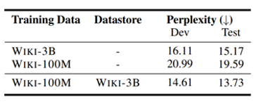

Figure 2 - kNN-LM: Experimental results on WIKI-3B. The model trained on 100M tokens is augmented with an adjacent datastore with 3B training examples and outperforms the plain vanilla LM trained on the entire WIKI-3B training set.
As can be seen in Figure 1, a model trained on 100M tokens (Wiki-100M) can achieve results that are materially better than a model trained on 3B tokens (Wiki-3B) by providing an effective retrieval mechanism (kNN-LM in this example) from a large and scalable datastore. The performance of the system in this case is driven by its mediated access to the information in the adjacent datastore rather than by the need to add more parameters to the neural network model or perform more gradient-based DL training on additional data.
As expected, the kNN-LM approach required substantially less computational cost to train the compact model, which could be accomplished with some CPUs instead of a large construct of dedicated GPUs. Due to the reduction in complexity of the DL inference model, run-time retrieval is performed on a CPU using a vector-similarity search library.

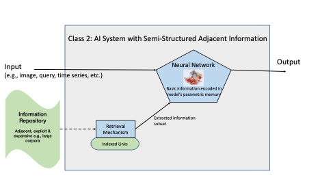

Figure 3 depicts the high-level architecture of a Class 2 system and its key components:
Figure 3 - Key elements of a Class 2 system
 The Neural Network contains information such as a language model. However, unlike AI systems of Class 1, the information encoded within the parametric memory represents only a fraction of the overall information required to successfully complete the tasks of the system. The neural network system has the additional capability to accept retrieved information at execution time and integrate this extracted information into its model. This incorporation requires some mapping of the retrieved information into the latent embedding space of the NN.
In this architecture, the training of the neural network needs to be done together with the retrieval mechanism and some representation of the adjacent information repository.
The Semi-Structured Information Repository contains data required for the performance and correct output of the AI system. When used to improve scalability, this auxiliary source contains substantially more information than what is encapsulated within the NN parametric memory. When used to improve flexibility or extensibility, the adjacent information repository contains the specific information that needs to be modifiable or extensible without retraining the NN model.
In many cases, the information in the repository is represented as corpora of plaintext documents that sit outside the AI system. In more specialized cases, the information source is included within a self-contained system such as that required for the size-constrained solutions to EfficientQA. For example, the UCL-FAIR submission, which was one of the winners in the constrained categories of the competition, incorporates a QA Database comprised of preselected pairs of questions and answers – 2.4M QA pairs in the 500MB track, and 140K QA pairs in the smallest-size track. The key architectural characteristic of Class 2 is clear in this system as the information resides in a separate explicit construct outside the NN and is being accessed for retrieval during execution time. This characteristic of Class 2 systems offers the opportunity to improve robustness to adversarial attacks which have been demonstrated on Class 1 systems, such as training data extraction. Since the source of knowledge resides outside the parametric memory of the model, access to information can be more easily controlled to prevent leakage of sensitive training data at inference time.
In addition to open-domain QA, retrieval-based systems have excelled in tasks like entity linking, slot filling, dialog, and fact-checking, as evidenced by the Knowledge Intensive Language Tasks leaderboard. Among others, the authors of knowBERT show that a knowledge-enhanced version of BERT performs better on LM perplexity and other downstream semantic challenging tasks like Word-in-Context (WiC).
Finally, the Retrieval Mechanism with its associated Indexed Links is used to extract the relevant subset of information needed to resolve a particular inference and serve it to the NN for integration and resolution. It mediates between the embedded latent space of the NN and the adjacent – usually explicit and intelligible -- information repository. The retrieval mechanism selects the most appropriate subset of information from what can be very a large-scale information source (such as selecting one particular passage from the 21M passages overall in Wikipedia). Methods can include associative approaches that operate directly in the embedded space such as with kNN. It should be noted that the retrieval mechanism could be implemented in code such as an associative library to extract from a database, or in a query language such as SPARQL to manipulate data in RDF format (for example, Question Answering over Knowledge Bases by Leveraging Semantic Parsing and Neuro-Symbolic Reasoning).
The Indexed Links can be a set of embeddings that represent the information source. Selecting a particular embedding (for example, with the shortest distance to a query embedding) will allow retrieval of the relevant information from the adjacent source.  In several systems, the indexed links can be modified or extended without retraining the NN. The scope of the system deployed at inference time can be as large as the space covered by its indexed links and can be broader than what was used during training.
