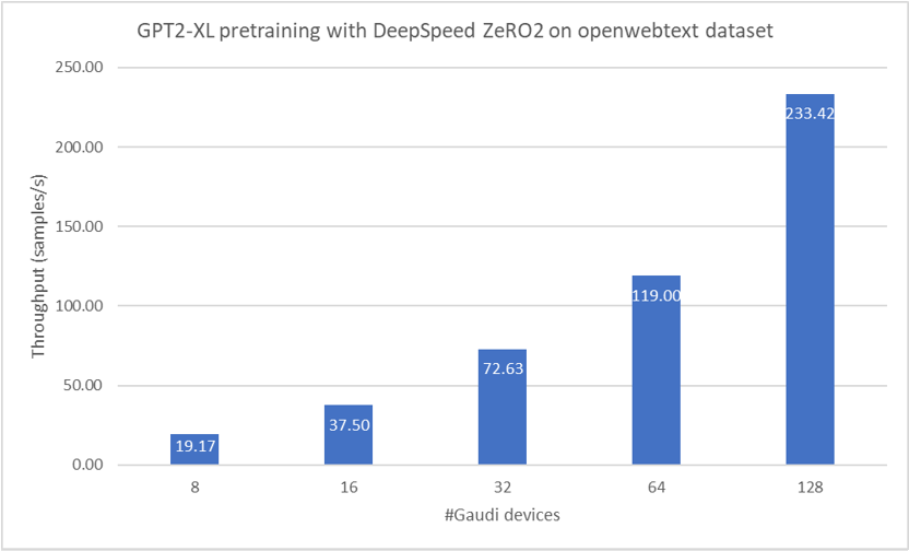

Samples Per Second Performance is calculated by the following equation [12]
Tokens Per Second is calculated by multiplying “Samples Per Second” with “Max Sequence Length”.  In the table below, ideal throughput is calculated by assuming 1x for single node and Nx that number for N nodes as the ideal linear scaling of 100%. Scaling efficiency is calculated by the ratio of actual throughout (samples per second) to ideal throughput.
# Devices Samples Per Second Tokens Per Second Ideal Throughput (calculated assuming ideal linear scaling of 100%) Scaling efficiency Grad Accumulation Steps
8 19.17 19630 19.17 100% 8
16 37.50 38404 38.34 98% 4
32 72.63 74370 76.68 95% 2
64 119.00 121856 153.36 78% 1
128 233.42 239022 306.72 76% 1
Table 1.  GPT2-XL pretraining throughput
We find that the training scales satisfactorily as the number of devices are increased.  With DeepSpeed ZeRO2, we find that samples per second scales from 19.17 with 8 devices to 37.5 with 16 devices, 72.63 with 32 devices, 119 with 64 devices and reaches 233.4 with 128 devices, showing reasonable scaling as the number of Gaudi devices are increased.
