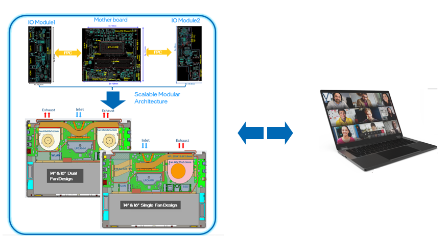

Entry/Mainstream Modular PC Architecture
  1. Scalable design with reduced engineering effort:  Multi-generation Silicon to achieve cost neutrality.  IO cards can be reused across segments within a platform. Redesign the IO cards to get multiple SKUs of the design.  Seamless scaling of 14-16" screen size, single Fan to dual fan thermal solution
  2. Ease of Upgrades:  Upgradable core, LPCAMM Memory, WiFi & SSD
  3. Simplified Repair:  Individually repairable IO boards, Thunderbolt® Technology Modules
Scalable Modular system design with modular LPCAMM Memory, M.2 Storage and WiFi. Type 3 8L Standard Loss PCB with BOM cost-optimized design catering to the mainstream segment designs targeting multiple form factors and screen sizes.
Figure 3 : Scalable MB, IO board for single & Dual Fan systems with FPC ChangeFigure 3 : Scalable MB, IO board for single & Dual Fan systems with FPC Change

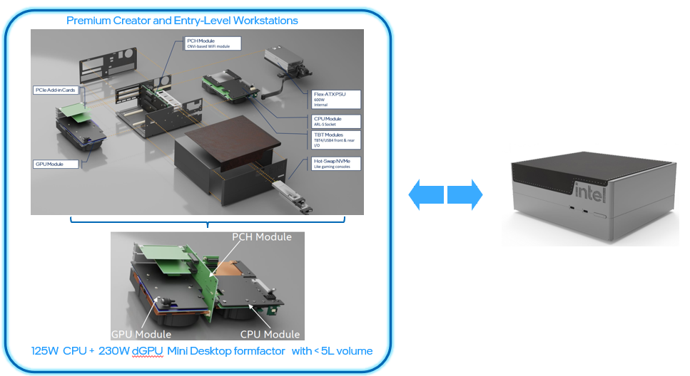

Desktop Modular PC Architecture
  1. Modular designs: Industrial design was created to provide the ideal experience for users with a focus on usability, repairability and serviceability.
  2. Ease of Upgrades: Removable CPU, SODIMM memory, and GPU (Graphic Processing Unit) using slide rails, along with hot-swappable storage.
  3. Simplified Repair: Highly Modular and Repairable Memory, PCH (Platform Controller Hub), GPU, and Thunderbolt® Modules on a high-density 5L Chassis
Figure 4 : Premium Creator and Entry level Desktop ModularityFigure 4 : Premium Creator and Entry level Desktop Modularity

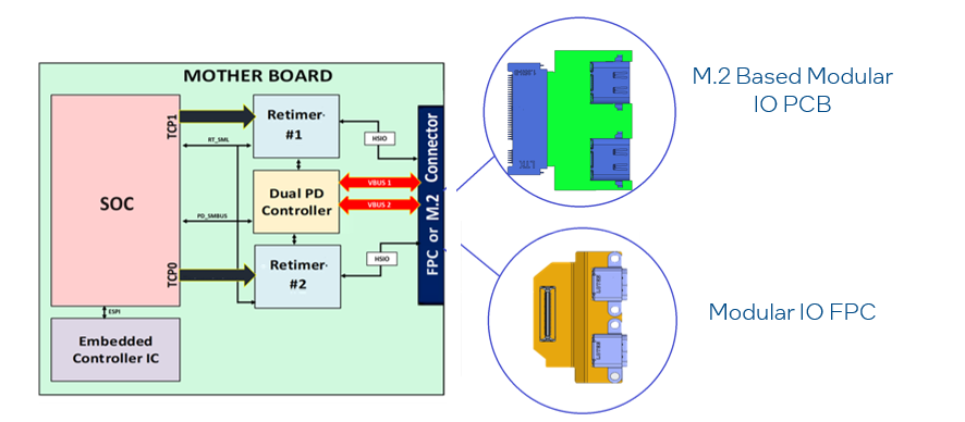

Intel designs are elevating modularity to the next level by introducing subsystem-level replaceable modules, such as a Type-C connector on an FPC (Flexible Printed Circuit) and a Type-C connector on an M.2 PCB. These modules significantly reduce repair costs and simplify the repair process in the event of port or connector damage at the end-user level.
Subsystem-level Modularity: Type-C on FPC, Type-C on PCB
Thunderbolt® Technology using a Type-C connector is a high-speed versatile interconnect with multiple end device options along with a power source to the system. Type-C connectors due to their delicate structure have been reported to get damaged more often than other IO ports. The Thunderbolt® post-channel modularity technology is a possible solution for addressing this repairability issue by adding the next level of modularity.
Figure 5 : Post Channel Thunderbolt® Technology Modular solutionsFigure 5 : Post Channel Thunderbolt® Technology Modular solutions
