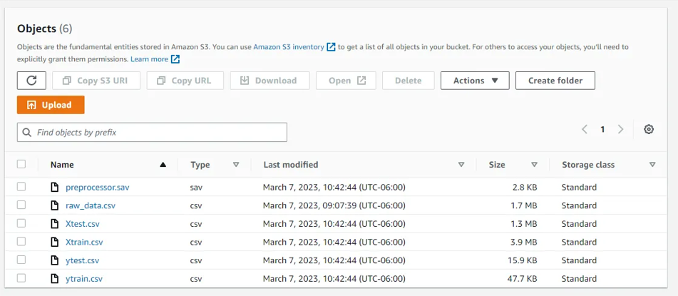

You can navigate to your S3 bucket in the AWS console to verify that all files have been properly generated.
 Figure 5. S3 bucket with the outputs generated by our /data endpoint — Image by Author
