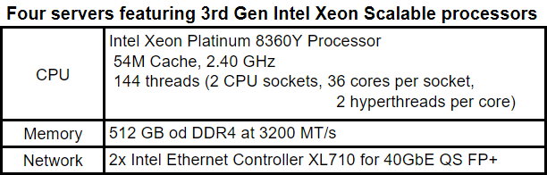

We performed these tests on four Intel Xeon Platinum 8360Y processor-based servers.
Figure 1: Hardware set
