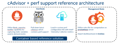

Third, now we can dive into container telemetry, specifically Google cAdvisor. cAdvisor (Container Advisor) provides container users an understanding of the resource usage and performance characteristics of their running containers. It is a running daemon that collects, aggregates, processes, and exports information about running containers. More specifically it captures resource usage per control group (cgroup) which can be applied to containers or VMs, but in this blog we are just focusing on containers. For each container it keeps resource isolation parameters, historical resource usage, and histograms of complete historical resource usage. This data is exported by container and machine-wide. We have worked to integrate performance counter support into the cAdvisor repo, therefore you can pull certain events for the container & specific for the host node as well. Here is a reference architecture we are leveraging to capture, collect, store & visualize.
cAdvisor + perf support
How do you get started? Here’s a reference script to pull down the cAdvisor pull with perf support & starting up cAdvisor with perf events support:
