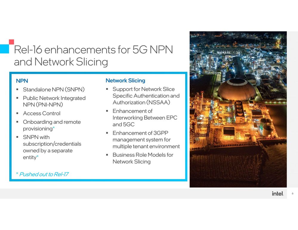

The 3GPP Rel 16 specifications defined support for non-public networks (NPN) as part of a broad study on Industrial IoT which included three key building blocks: 5G LAN-type services, Time Sensitive Communications, and Non-Public Networks.
An NPN may be deployed as a Stand-alone Non-Public Network (SNPN), in which case it is operated by an NPN operator and is not relying on network functions provided by a public land mobile network (PLMN). An NPN may also be deployed as a Public Network Integrated NPN. These PNI-NPNs are NPNs made available via PLMNs by means of dedicated distributed network names (DNNs), or by one or more Network Slice instances allocated for the NPN [3].
Remote provisioning is one of many things planned in the forthcoming Rel-17. Study is ongoing for enhanced support of stand-alone non-public networks, with credentials owned by an entity separate from the SNPN, with onboarding and remote provisioning on the SNPN.
