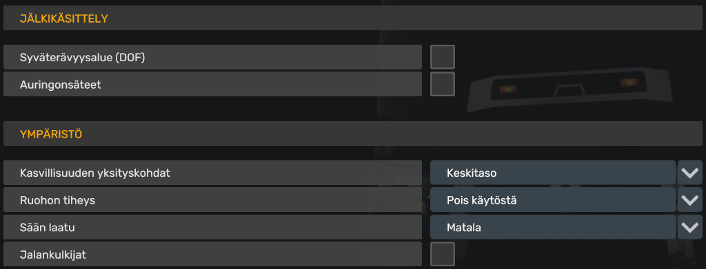

Thank you very much for your patience and for following up with me. As requested, I am using the following resolution in Euro Truck Simulator 2
I have attached screenshots of my in-game video/graphics settings for your review.
Please let me know if there is any additional information or testing you would like me to provide. I appreciate your assistance and support.

Hi Emre_EU,
Thanks for waiting, please try to do a clean installation of latest Intel® Graphics Driver 32.0.101.8531 by using Display Driver Uninstaller (DDU) first to completely uninstall the current driver before installing the latest 8531 driver.
Here are the links for your reference on how to do a clean installation using DDU: How to Use the Display Driver Uninstaller (DDU) to Uninstall a... and Clean Installation of Intel® Graphics Drivers in Windows*
If the low FPS issue on the game Euro Truck Simulator (ETS 2) will persist, please provide an updated SSU logs of your system and new CapFrameX of Euro Truck Simulator 2 (ETS 2)

Hi Kent,
Thanks for following up. I’ve reviewed the information and everything is working as expected now. I don't have any further questions, so we can go ahead and close this case.
Emre
