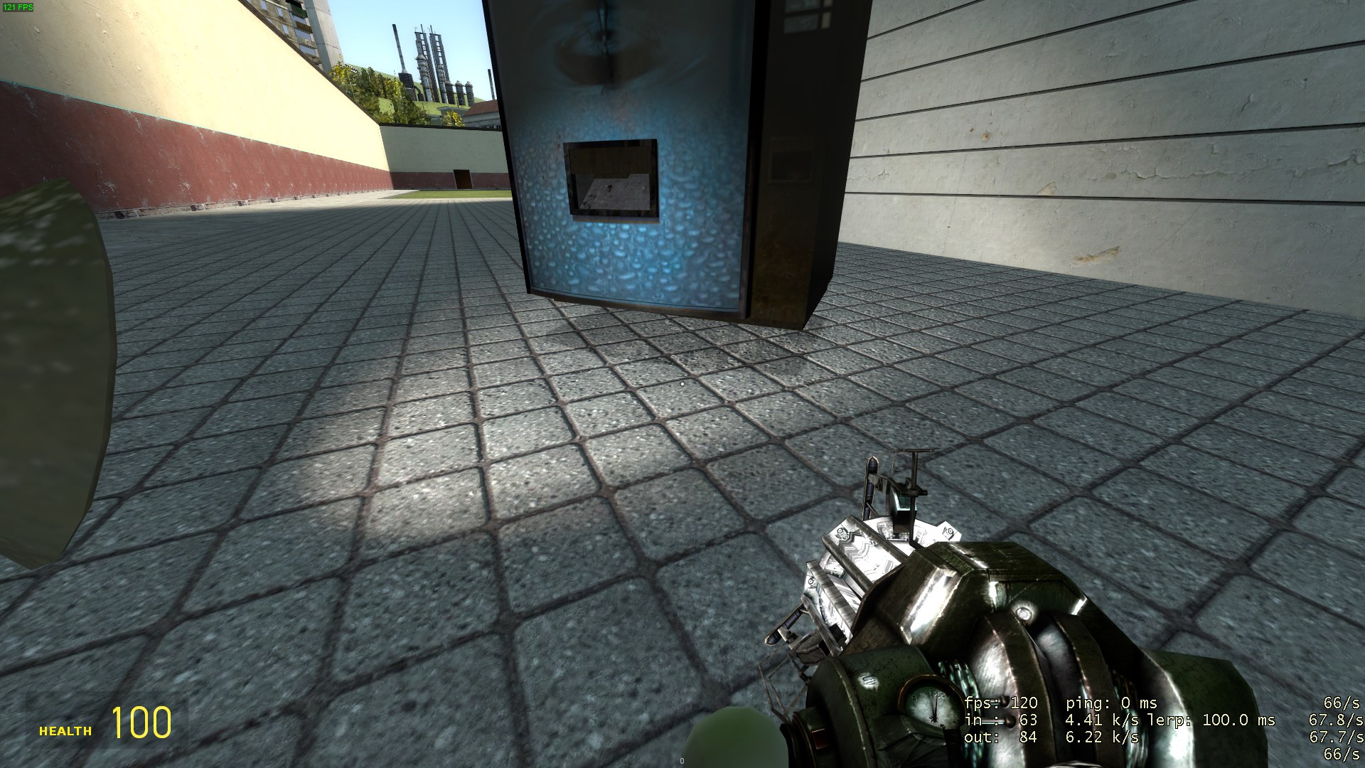

Ive been having wierd issues on my Intel arc A750 gpu on games like garry's mod, Stuff like shadows acting wierd, and fps issues. please help, it would be cool.

Hello ThenonFun,
Thank you for reaching out to our Communities and for providing the screenshots. As seen on the photo, you are encountering artifact like graphical errors on your Arc A750 while playing Gary's Mods

Hi, I havent made any changes to my system since i built it in january, this has always been a problem in garry's mod, no i havent done any trouble shooting steps, and i after looking at hl2 and source sdk base 2013, the shadows look normal, but in gmod, the showdows look like they are z-fighting in someway. This (MIGHT) exist in other source titles, but i just havent been able to recreate it. This shadow glitch also only happens when another light source is being flashed on the existing dynamic shadow. Also none of my friends with NON intel gpus (Nvidia rtx 3060, 4060, 1650, 1650 laptop ) havent experienced this issue.
extra info incase you need it
cpu: 123400f
gpu a750 asrock challanger
ram: 16 gigs
Gpu driver version: 32.0.101.6739

The version of garry's mod im using is the most recent x64 Build of the game,(2025 may patch), reinstalling the game does nothing, neither did updating the drivers. Im also fell like im getting less fps then im ment to, I should be easially getting 120 fps or more, but im dropping to 90 and even lower on highest 1080p on some maps.
I feel like this might be a driver issue with the "low" fps and shadow bug.
also heres the map for garry's mod i use to test these things:
