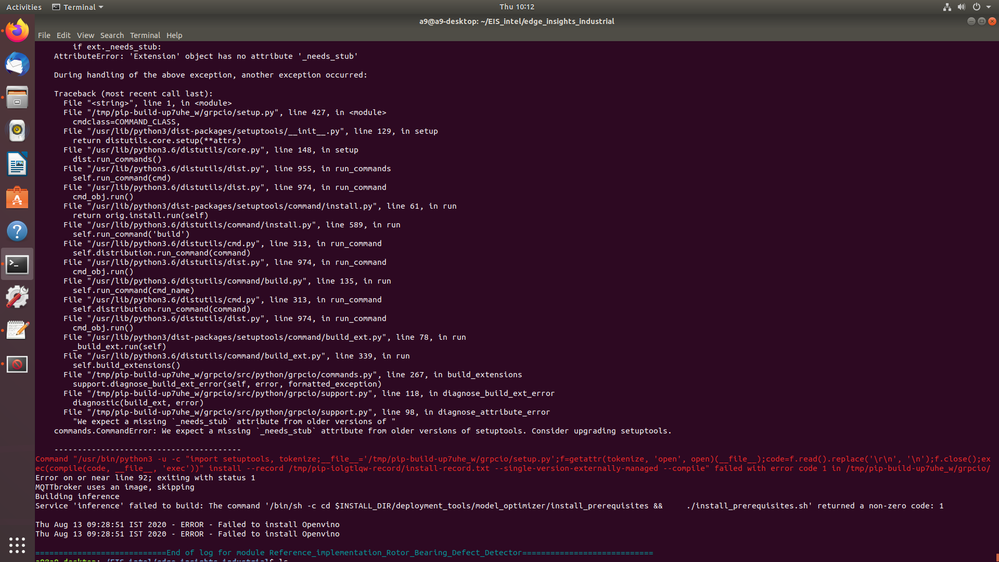

Hi, I have a CPU
" Intel® Xeon® W-1290P Processor "
with mother board
" Asrockind's  IMB-1313 "
with a 16Gb RAM plus another 8Gb RAM (all using Kingston)
and a HDD of 1TB
OS : Ubuntu 18.04
When I try to install  " Edge Insights for Industrial 2.2.1 "
For the " Rotor Bearing Defect Detector " module
I do follow the steps at this link
https://software.intel.com/content/www/us/en/develop/articles/rotor-bearing-defect-detector.html
How ever I have met  failures at building the docker image.
The problem seems to be associated to the pip tool's version?
Screenshot from 2020-08-13 10-12-40.pngScreenshot from 2020-08-13 10-14-22.pngScreenshot from 2020-08-13 10-17-30.png
the output of the log is attached.
Since there are only  3 kinds of package( 6th, 7th, 8th gen~ core), I suspected that this may due to the unsupported 10th generation core of this CPU  " Intel® Xeon® W-1290P Processor ".

HI @J-N-ch
Seems like you failed to download the OpenVINO, did you give the download link of openVINO while installing ?
J-N-ch
4,660 Views
Yes, I did.
I failed to  "install" OpenVINO, not "download".
For downloading OpenVINO, I think it is works fine in downloading OpenVINO.
the problems seems to be happening when trying to install the OpenVINO in the docker.
