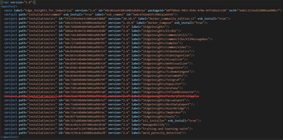

In the meantime, if you do not plan to use factory control app, you can remove it in the [work_DIR]/edge_insights_industrial/edgesoftware_configuration.xml.
Refer the following image:

Hi Haizad,
I have tried removing factory control app from edgesoftware_configuration.xml file. But getting the same error again.Screenshot from 2021-10-06 10-36-08.pngScreenshot from 2021-10-06 10-35-56.png

Hi Saravanan_M,
Can you uninstall using the command edgesoftware uninstall -a, then delete edge_insights_industrial and re-create it by unzipping the download package. Once the new directory is created, you can edit edgesoftware_configuration,json and remove the factory_app line.
