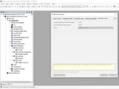

Hi there,
We've completed the setup for this lab. Please refer to below information in detail.
Now we're running this CODESYS project, and it seems to have another window pop-up to ask for project environment checkup. We would like to confirm:
   - Should we update the libraries and click 'Set All to Newest'
   - How to download the device description ?
Thank you.

Hi Jonathan,
I don't think it's absolutely required to update the libraries but it's not a bad idea, in case CODESYS has bug fixes in them.
You can right click on the exclamation mark next to the device to download its device description.
Hope this helps.

Hi Jia-Shing,
Thank you for your feedback.
Now the gateway and ECI target system can be recognized. I think we can proceed then.
