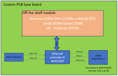

WGI210A Ethernet controller IC is being used on our custom CPU base board and Ethernet controller on based board is connected to Kontron COMe module (Intel atom-based SOM) through PCIe.
RTOS (VxWorks) is being used on Kontron CPU module.
When we are trying to attach the device driver to the controller as a PCIe device. It is found that device has been not programmed in factory and later: its PCI device ID is 0x1531 instead of 0x157B according to I210 specification update (§Table 1-2 Device IDs).

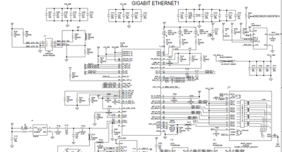

Schematic reference:
Block Diagram:

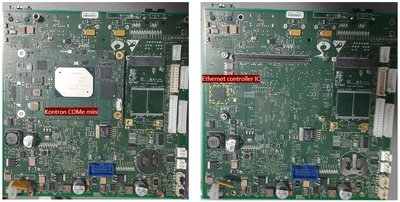

PCB images for reference:

Note: Above mentioned Custom PCB board designed as Control board for our X-ray based system with Ethernet controller IC (WGI210AT).

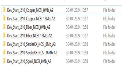

-#513655 - Intel® Ethernet Controller I210 and I211- AT Production NVM Images.
-#333016 - I210 Datasheet
In the #513655 there is a file called Programming iNVM in i211, this document is applicable to the i210 too.

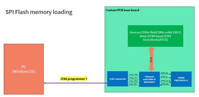

1. As per our understanding to update iNVM memory, Application EEUpdate and LANConf to be executed from the Host processor (In our case Kontron SOM module) connected to the Ethernet controller. Is it correct?
2. If I need to program SPI Flash memory (FM25V02A-G) through JTAG, what type of JTAG programmer to be used to Flash binary from PC?
3. The flash memory used in our system is the FM25V02A-G, with a capacity of 256 kb. In the 513655 document, most of the available binary files are significantly larger, such as 8Mb, 16Mb, etc. Considering the size of our flash memory, which binary file should be loaded?

1) Yes, both tools should be able to recognize when a NIC is connected to the board.
2) Regarding JTAG, I looked internally but I didn't find which program is recommended, I think you can try PuTTY in Windows.
3)  Regarding the ROM files, those are dependent to the design, as this design is from Kontron, it may be best if you reach them to make sure if you need any of those and which one, or use an iNVM and update the MAC as the i210 has flash-less support.
