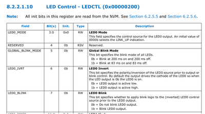

Hi Sir,
Regarding X550-AT2, how to get the address for LED behavior from X550 datasheet?
I'd like to change LED behavior by hex editor. I know how to modify it, but I don't know how to calculate and get right address.  Could you share the process for me?

Hello @Cody_Kuo,
You must search the BAR0 registers.
LED Control says it is in the offset 0x00000200.
You can modify the bits according to the table 8.2.2.1.10.
