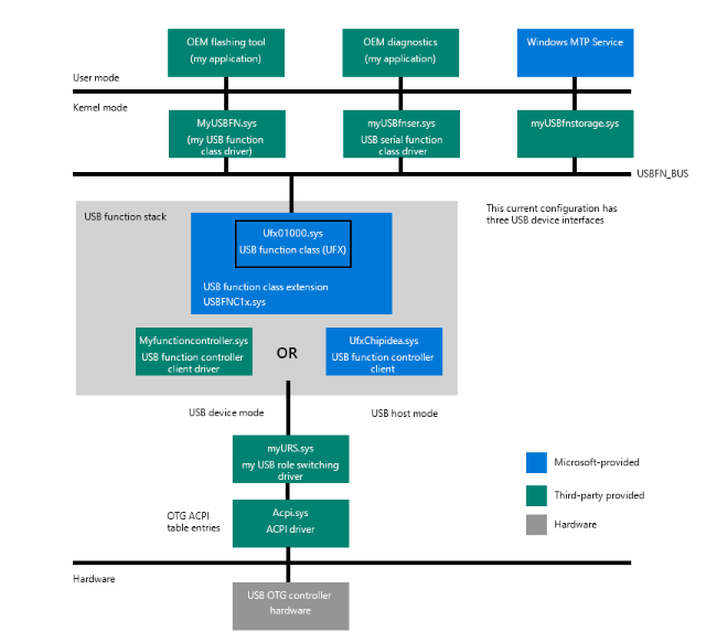

Please let me paraphrase the information stated on page 11 of the suggested document. The USB drivers listed in the BKC document are inbox as the ACPI. Due to this fact, they have been developed and supported by the OS developer.

I will elaborate my requirement in brief. My requirement is to make the intel atom e3930 board running on Windows IOT Core OS to be recognized as a COM port when I connected USB 2.0 port of the IOT Core board to USB port of other Host machine running on Windows 10 Desktop OS. For that we need to have following drivers as explained in the link "https://docs.microsoft.com/en-us/windows/iot-core/learn-about-hardware/usb-support"
  1. Acpi driver
  2. URS driver
  3. USB function controller client driver
  4. USB Function class extension driver
  5. USB serial function class driver
Screenshot of the same is attached for your reference,
We assume "USB Function class extension driver" is provided by micro soft as the inbox driver.
And all other drivers should be available as part of the BSP or we need to develop from our end. So I assume USB function controller client driver currently not available in the BSP, so I am trying to develop my own. So I pleased to have your full support on how to accomplish the same.
