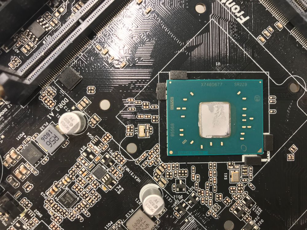

​This situation happens on our design but I can't provide our sources . However, I found the same issue on a ASRock's motherboard: J3455-ITX. There are I can provide for your questions:
  1. ​About the ASRock's motherboard, its Part Number is 90-MXB3W0-AOCAYZ and the documentation in https://www.asrock.com/MB/Intel/J3455-ITX/index.us.asp#Specification.
  2. This situation happens on all 3 test motherboard(1 our J3455 board, 1 our J3355 board, 1 Asrock's J3455-ITX ),they tested in same environment (same memory, SSD disk, OS,maximum TAT6 workload).
  3. When CPU ALL workload + Gfx workload 100% in TAT6 , J3455-ITX's result is IA Power 5.8W, Integrated Graphics 5.3W, Package Power 10W.
  4. ​When I use Intel(R) PTU , this situation still exists.
  5. This isJ3455-ITX's processor:IMG_3181.JPG
