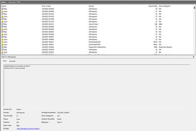

Hi, first of all I would like to thank Intel for producing a great network card. Thanks also to MSI for using this excellent network card in their excellent motherboard.
I'm using the MAG Z690 TOMAHAWK WIFI DDR5 model. I just recently built my computer. The I225-V is really a nuisance. Since the first day I built the computer, even though I tested all the drivers of Windows 10-Windows 11 and tried functions such as turning off the power management, it never came to a solution. As a last resort, I'm thinking of sending the motherboard back and getting a new one. This will be a bit of a hassle for me.
Isn't there a solution to this?
Intel(R) Ethernet Controller (3) I225-V
Network link is disconnected.
Network link has been established at 1Gbps full duplex.
Driver Version: 2.1.3.3
Windows 11 build version: Windows 11 Pro 22H2 22621.1555
Bios version: AMI BIOS7D32vHB
Cable Modem: Cat8
Internet connection speed: 1gb/2.5gb? 1Gbit
Speed & Duplex: Have you configure to auto or match your internet connection speed? 1.0 Gbps
Note: I even changed the modem in the process. I bought a new modem.

I am using the latest 2.1.3.3 for Windows 11. Which driver would you recommend? This suggested solution didn't work. Still connection drops.

It does not come back after the connection is lost. I am using the Windows Diagnostic tool to solve this. It says the problem is "Default gateway not available" and when Windows fix it the internet comes back.
"Default gateway not available Repaired Repaired
