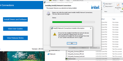

3. When I uninstall the device, reboot, and attempt to re-install the Intel® Ethernet Adapter Complete Driver Pack you linked after reboot, I am met with this screen:

Since this is from our OEM, as per checking, we found that the driver pack from MSI is different with INTEL driver pack
You may try to reinstall the NIC.
https://www.msi.com/Motherboard/Z590-PRO-WIFI/support#driver

So I went to your link and downloaded and extracted the zip file of "Intel Network Drivers" version 26.2.0.1 under the subcategory "LAN Drivers". I auto ran the app and attempted to install it was met with this screen:
I also tried the "Intel® Ethernet Adapter Complete Driver Pack" again and was met with this screen (just to show the difference in the pop-up messages):

You may try to ping your NIC by using CMD to verify whether the NIC is sill function or not.
  1. Determine the IP address of the NIC that you want to ping. You can do this by opening a command prompt and typing "ipconfig". Look for the IP address assigned to the NIC that you want to ping.
  2. Open a command prompt and type "ping" followed by the IP address of the NIC that you want to ping. For example, if the IP address of the NIC is 192.168.1.2, you would type "ping 192.168.1.2" and press Enter.
  3. If the NIC responds to the ping, you should see a series of responses in the command prompt indicating that packets are being sent and received. If the NIC does not respond to the ping, you may have a connectivity issue.
  4. Keep in mind that if you have both a NIC and a WIFI card active at the same time, your computer may prioritize one over the other depending on your network settings. To ensure that your computer is using the NIC for your ping, you may need to adjust your network settings or disconnect from WIFI temporarily.
If still having the issue even installed specific Ethernet driver from MSI. The Ethernet card might be damaged.
Since you are using MSI product, with embedded NIC, contact MSI support for further assistance. They may be able to provide additional troubleshooting steps or even replace the motherboard if it is found to be defective.
You might provide them your concern. They are still the best team to assist you.
