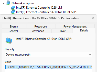

Thanks for the help and here is a screenshot and the device ID of the NICs.

This turned out to be a driver issue with the latest Intel and even Dell's offerings. Once I uninstalled the NICs in Device Manager and rediscovered them, Windows installed a driver from 2023, and SET is working correctly.
