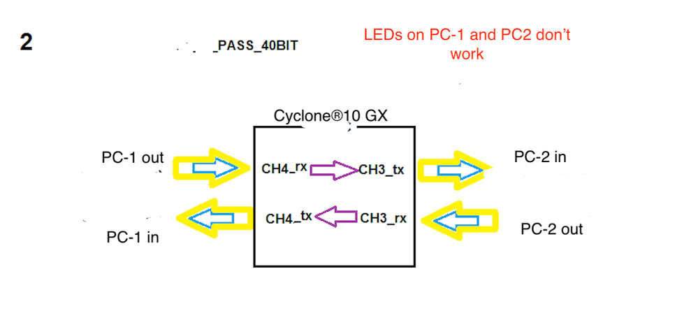

I'm making an optical switch based on FPGA Cyclone 10GX, PHY – protocol 10GBASE-R.
Unfortunately when I connect it to PC - LEDs on PC's controller don't work.
Details:
PC-1(controller SFP+) => fibre cable — ch4PHY_RX-xgmii- ch3PHY_TX => fibre cable - PC-2(controller SFP+)
PC-1(controller SFP+)<= fibre cable — ch4PHY_TX-xgmii- ch3PHY_RX <= fibre cable - PC-2 (controller SFP+)
Result: — controllers (SFP+) on PC-1 and PC-2 don't light LEDs that fibre cable is connected.
But when I connect controllers on PC-1 and PC-2 directly - all work well - LEDs work:
PC-1(controller SFP+) => fibre cable  => fibre cable - PC-2(controller SFP+)
PC-1(controller SFP+)<= fibre cable  <= fibre cable - PC-2 (controller SFP+)
Question-1: Can  controller  SFP+ work in 10GBASE-W  mode (WIS packages of 10GBASE-R convert to frames compatible with SONET / SDH protocols) so there is no connection PC-1 - (FPGA_ 10GBASE-R) – PC-2 ?
Question-2: Can  GEARBOX mode of SFP+ controller ( 66bit=>40bit or 66bit=>32bit) affect to communication between SFP+ controller and FPGA Cyclone 10GX PHY – protocol 10GBASE-R ?
Question-3: Which GEARBOX mode is used SFP+ controller ( 66bit=>40bit or 66bit=>32bit) ?
ps-1. board schema and params are attached
ps-2. ssu output of Intel network controller is attached too
schema of my board:
parameters:

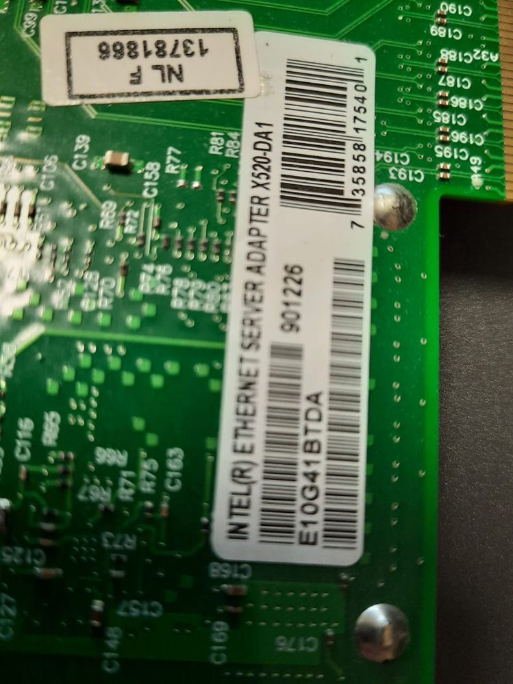

Hello SGeor22,
Can you please share the exact model of your adapter and SFP+ module used? If possible, kindly share the PBA of the adapter and photos of the SFP. You may refer to the link below on where to find the PBA number. It consist of 6-3 digit number located at the last part of the serial number. This would help us identify if you are using an Original Equipment Manufacturer(OEM) or retail version of Intel Ethernet Adapter.

Adapter photos:
(PBA-num: E68793-002)
adapteradapteradapter's PBA numadapter's PBA num
adapter.back-sideadapter.back-side
