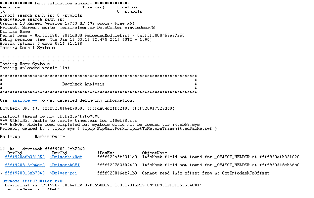

VecteurIT
7,178 Views
Today a BSOD : i have not symbols for X722
Where can i found it ?
Daniel_D_Intel1
7,178 Views
Hello VecteurIT, Thank you for the update. Please try to update your drivers to 23.5.1. This was released just after 23.5 and provides support for the X722. Let us know if this changes anything or if you have any other questions. Best regards, Daniel D Intel Customer Support
