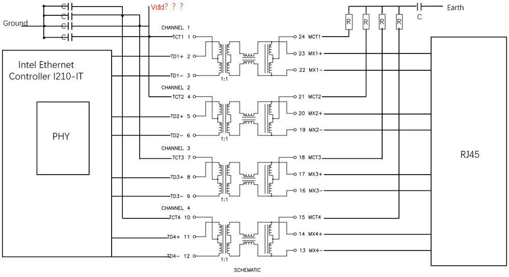

I have a design contains your two chips:Intel Ethernet Controller I210-IT & Intel Ethernet Connection I219LM, and I need to add electrostatic protection. So I choose a Network transformer from Pulse (H5008NL).
I seach the datasheet of I219LM and I210-IT, but I still don't know the type of the Chips‘ PHY, so I don't know the red font(“Vdd???”) in the picture below is need or not?
I google the question,it tells me: if the PHY's tpye is current sources, the "TCT1,TCT2,TCT3,TCT4" should connect a Voltage(Vdd) and a capacitance. if the PHY's tpye is voltage sources, the "TCT1,TCT2,TCT3,TCT4" should just connect a capacitance.
So I want to know which design is correct? And I hope to get a recommended design.
Thanks!
