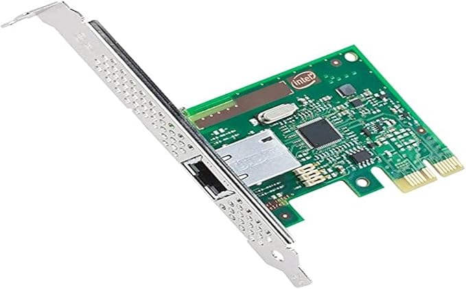

Hello ,
A desktopPC with
CPU : Intel(R) Celeron(R) CPU J1900 @ 1.99GHz Intel64 Family 6 Model 55
Mainboard : ASRock Q1900M
BIOS : P1.70 ALASKA - 1072009
OS : Windows 10 Pro 1809 17763
NICs we have purchased are the same in this picture : link
A new information , i installed the card to an identical pc with windows 11 .There the PTP option is seen available in adapter settings. PCs are identical. So the hardware does not seem to be the issue.
Elif

(I have shared the photos with Pujeeth via private message. Here is the post for public share)
Here are the photos.
However i think , this is not the right direction we are headed. The card is installed without problem.
As i have already informed, it has no problem unter Windows 11. I can even see the NIC's ptp option under Win 11 ( i am looking for a way to test it now if the driver supports the WinAPI for ptp , but not only show the hardware option to turn on /off)
Question is why i cannot under windows 10 (1809 which should be the version also supports NIC's this feature.)
Best Regards
Elif
