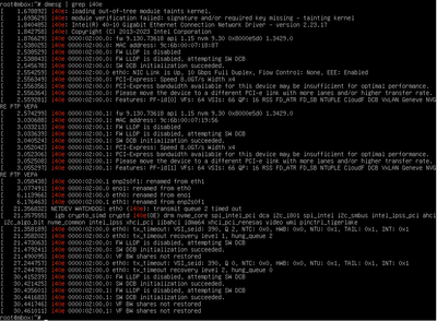

Hello, I need help with the X710-AT2 (on an Asrock E3C256D4U-2L2T board). It doesn't work on Ubuntu 22.04/Debian/Proxmox, but it works under Feroda. So I think it is a problem with the operating system, drivers or network card configuration. I have the latest NVM (9.30), i40e (i40e-2.23.17) and iavf (iavf-4.9.1). LLDP along with all network management is disabled in BIOS. The network card is seen by the operating system, but I cannot get any traffic thought. I get rx_dropped packets on the interface, but rather none are transmitted. The interface tries to get an IP via DHCP, but mostly fails; sometimes it does, but no TCP transmission seems go thought. I managed to get it to work twice, probably by accident, when I experimented with the settings `ethtool -G eth12 rx 256 tx 256; ethtool -C ethX adaptive-rx off adaptive-tx off rx-usecs 0 tx-usecs 0`. The working state did not survive the reboot, and the commands that made it work (or anything else) did not make it work again.
I forced a vlan ID on the switch port along with the only untagged option. I thought all this behaviour might have something to do with VLANs, but connecting the interface to another router with no VLANs configured doesn't let any traffic through either.
Normally I'd say it's some kind of hardware problem (switch/cable/interface), but the interface works on the latest Fedora 38 LiveCD every time, after multiple reboots, and it's forwarding packets without any errors visible on the switch.

Sorry, just to clarify: mbox.txt is from not working ubuntu, other screenshots was from working fedora just to prove it is working.
This might also be handy. You can see TX errors. This is from ubuntu 22.04 with Intel drivers installed.

Hello.
In my last message I provided you modinfo showing that module is loaded it seems. I did reboot after driver install, just to make sure. Anyway. I'm attaching output from commands you requested:

Hello @Faez_Intel anything else that I could check? Problem still persists.
I contacted ASRockRACK and they confirmed that this problem also occurs on other boards with the same network interface. I believe this confirms that the problem is not related to my network configuration/setup.

Also, to ensure the drivers are actually loaded onto the system, please kindly use the below command and let us know on the output.
modprobe -r i40e; modprobe i40e
This is due to the previous command of "modinfo i40e" will only show if the i40e was only installed on the system, but does not necessarily means it will be loaded by the device.
Next, we need to confirm kernel information:
uname -r
grep "" /etc/*-release
We also need to consider link state:
ip -d link show enp2s0f0
ip -d link show enp2s0f1
Since you also made mention of "rx_dropped packets" Please kindly provide the statistic values to confirm the dropped packets:
ethtool -S enp2s0f0
ethtool -S enp2s0f1
Lastly, you have stated the following: "The interface tries to get an IP via DHCP, but mostly fails"
For this, we need to know on how you obtain the DHCP. You may let us know on what commands or mechanism used in order to obtain the DHCP
In the meantime, since there was a hardware related comment that you made regarding on the screenshot with the below errors:
i40e 0000:02:00.1: PCI-Express bandwidth available for this device may be insufficient for optimal performance.
i40e 0000:02:00.1: Please move the device to a different PCI-e link with more lanes and/or higher transfer rate.
Some PCIe x8 slots are actually configured as x4 slots. These slots have insufficient bandwidth for full line rate with dual port and quad port devices. In addition, if you put a PCIe v4.0 or v3.0-capable adapter into a PCIe v2.x slot, you cannot get full bandwidth.
For this issue, moving your adapter to a true PCIe v3.0 x8 slot will resolve the issue for this particular error.
