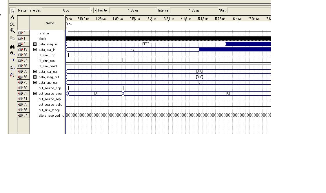

Hi to all,
I'm testing FFT core v8.1 with Quartus Simulator and the output is always 0. I attach a image of my input signals. http://www.alteraforum.com/forum/C:%5CUsers%5CDuarte%20Carona%5CDesktop%5CSimulator.jpg Thank you. Duarte Carona- Mark as New
I faced that problem before. But for me, I was able to see outputs after i decrease my clock period from 10ns to 1ns. Maybe you could try that.- Mark as New
Ok, i'll try that.
Thank you- Mark as New
--- Quote Start --- Hi, I faced that problem before. But for me, I was able to see outputs after i decrease my clock period from 10ns to 1ns. Maybe you could try that. --- Quote End --- 1ns clk period means 1000MHz(1GH). Too good to be true for any fpga. I am afraid you are on the wrong path.
It seems that I am having the same issue. My fft_sink_ready signal (called out_sink_ready) is being set to 0 after being asserted to 1 a couple of cycles before. I do not know why this is happening. Any help with this matter will be greatly appreciated. Furthermore, since I am aware of the scaling issue in the streaming implementation, I ensured that the real input is FFFF (16 bits) - the largest number possible. Thank you!- Mark as New
--- Quote Start --- Hi, It seems that I am having the same issue. My fft_sink_ready signal (called out_sink_ready) is being set to 0 after being asserted to 1 a couple of cycles before. I do not know why this is happening. Any help with this matter will be greatly appreciated. --- Quote End --- I had this problem, too. Go to the wizard you created the IP-core with. Check the checkbox including the global clock enable signal. Apply a logical high level signal to the input. Then the IP-core should not stop working after the first cycles.

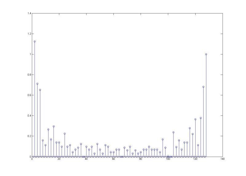

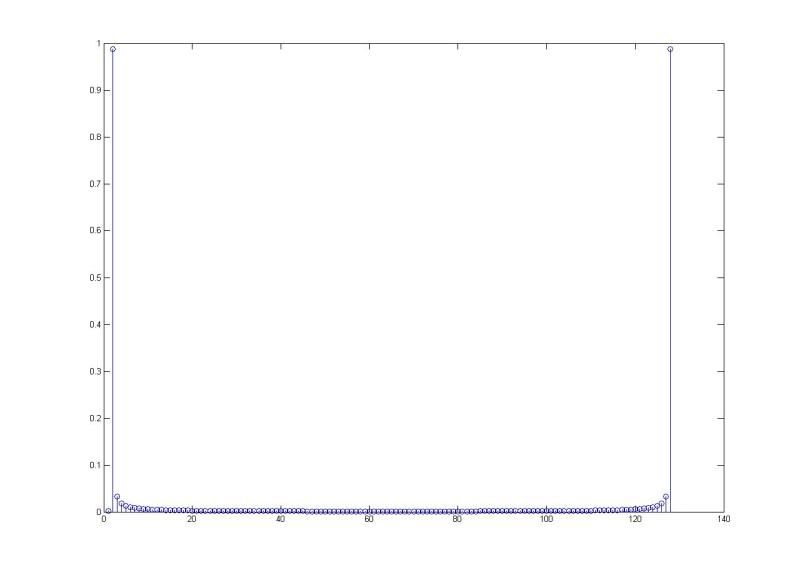

I am trying to use FFT Megacore function and got a different result from MATLAB Following is my code
t=0:0.001:0.127;
y=2*sin(2*pi*8*t);
Yfft=fft(y);
stem(abs(Yfft)/128);
= MegacoreFFT_VHDL_model(y,128,0);
ymega_change=abs(ymega)*2^2/128; %exponent = -2 and I normalize to 128
stem(ymega_change);
Here are the 2 graphs: 1st one is MATLAB FFT, 2nd is MegaFFT Am I making any mistakes ? http://i111.photobucket.com/albums/n126/leejongfan/FFT.jpg http://i111.photobucket.com/albums/n126/leejongfan/MegaFFT.jpg
