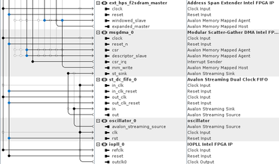

I am trying to connect the AV DC FIFO as followed:
The idea being that the main clock is running at 100MHz and is connected to the mSGDMA which reads from the FIFO, and iopll is outputting a 200MHz clock and is connected to the oscillator which writes to the FIFO.
The above design compiles, but on boot I am given this error:
..Error sending bitstream!
Command 'load' failed: Error -110
FPGA not ready. Bridge reset aborted!
Note that this design works when there is no PLL, and everything is clocked from the same source (although this causes boot to take a long time).
I have looked through the docs here however these docs seems not to match the IP interfaces.
The docs here here seem to match but don't explain the interface.
Could someone help point me in the correct direction?
Thanks!

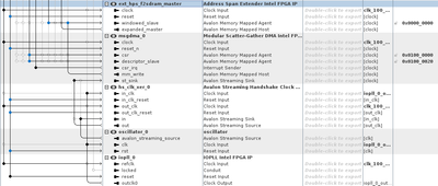

Understood that. Could you try to use the simple adapter ST handshake clock crosser under the bridges and adapters section? I think you're connecting it correctly previously. Instead of using dual clock fifo under on-chip memory section, as it's embedded peripheral I'm not sure is there anything needs to take note when using it.
Regarding why booting slow when using 200mhz, you need to open a new thread target pcie to get the related pcie expert helps.
Sheng
Seems like a cdc problem where msgdma read from fifo at 100mhz but oscillator write to fifo at 200mhz.
If you make the clock frequency same does the problem resolved? If yes, I would suggest you to add one Avalon® -ST Streaming Pipeline Stage IP in between the msgdma and fifo reading to increase the reading frequency to 200mhz
Sheng

Another one will be using Avalon Streaming Handshake Clock Crosser IP.

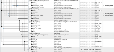

Hi @ShengN_Intel,
I can confirm that with the 50MHz clock this design works:
With a verilog defined for the clock:
// Qsys Top module
assign sys_clk_50 = REFCLK_50;
qsys_top soc_inst (
.clk_50_clk (sys_clk_50),
I would note, however, that I do not have another clock going faster than my main system clock to test with - which is why my application will be relying on a PLL.
What would you suggest to try now?
You mean you change the pll frequency to 50mhz or connect the oscillator to 50mhz?
Does the device got 100mhz clock?
Sheng
Could you try test case below:
Test1: Main clock(50mhz) -> pll (50mhz) -> all peripherals
Test2: Main clock(50mhz) -> pll (100/200mhz) -> all peripherals
Are both tests pass?
Main clock(50mhz) -> pll (200mhz) -> all peripherals did work! Thanks.
However - the system boot is now much much slower. Maybe 10x slower.
Do you know why this could be??
Many thanks.
