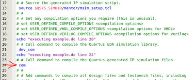

The Quartus simulation setup script generation seemed to go well, however still having issues with Intel IP during Questa compilation.   Currently stuck on the Bus Functional Model IP for AXI4lite.
Getting this error:
This library being called in the Quartus-generated HDL doesn't exist.
This error occurred during the com step in the .do file that was created as shown in the video.
Do you know why this library isn't being generated by Quartus?

Check this document link https://www.intel.com/content/dam/support/us/en/programmable/support-resources/bulk-container/pdfs/literature/ug/mentor-vip-axi4lite-ae-usr.pdf (page 374):
To run a Questa simulation, follow the process detailed in “ModelSim Simulation” on page 370.
page 370:
Ensure that the environment variable MvcHome points to the location of the installed BFM.
page 371:
Starting a Simulation from the ModelSim GUI
page 372:
Starting a Simulation from a UNIX Command Line
page 373:
Editing the modelsim.ini File
This link may be can help you also https://www.macnica.co.jp/business/semiconductor/support/faqs/intel/131065/
