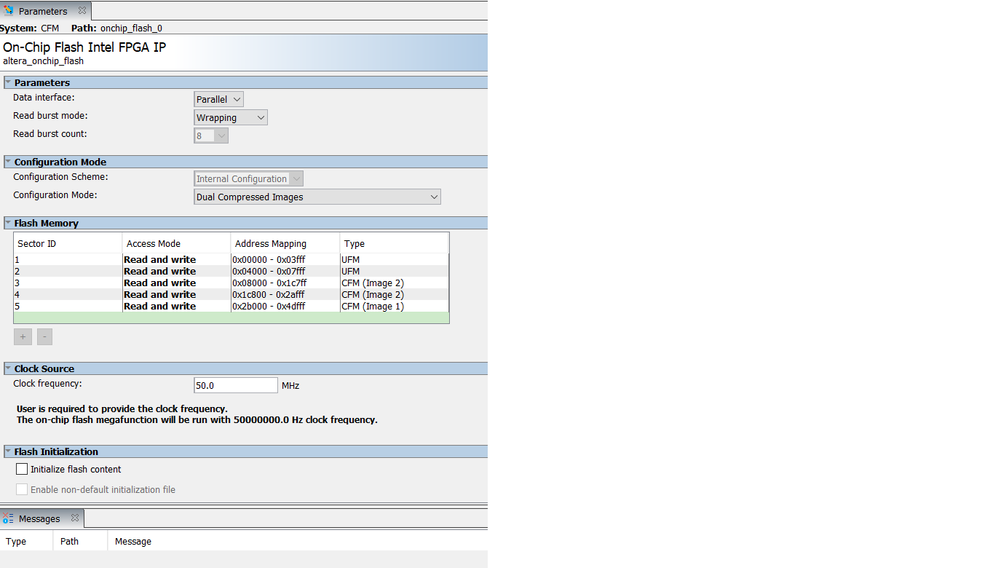

I want to Erase CFM0,but it seems like flash didn't response.
KWang97
751 Views
无标题.pngI want to Erase CFM0,but it seems like flash didn't receive my command. Why?
Below are code:

  1. May I know how do you connect the clk to the On Chip Flash IP?
  2. Is it from internal Oscillator or clk pin?
  3. What is the clk frequency used?
  4. Could you read the status register (CSR_ADDR = 0x0) after you disable the write protection and after you execute sector erased?
KWang97
572 Views
Thanks a lot!
I have solved this and the problem is caused by wrong reset signal.
