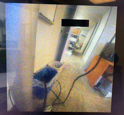

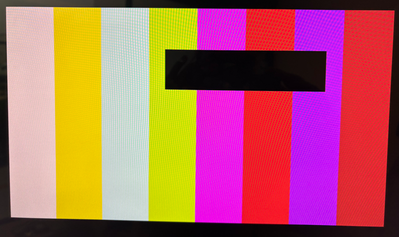

Hello Wincent,
Thank you for the quick response. The target device is 10AX115H2F34E2SG.
  1. I adjusted the red gain via a color space converter and the ROI region remained black while the color bars changed.
  2. When I attempt to use larger ROI values typically the function call to intel_vvp_tmo_set_roi_horizontal_x0x1 or intel_vvp_tmo_set_roi_vertical_y0y1 will hang the nios2 processor. On one attempt I was able to set vertical 0->1060 and horizontal to 0->1900. The black area still appeared with a small bit of the test pattern visible.
  3. I also happened to try a 800x800 camera feed and the results were the same.
Color Bar with Red Gain Set to ~8x:

Wincent_Altera
1,779 Views
HI @dscully ,
Thanks for trying that, I just try to understand better
intel_vvp_tmo_set_bypass is set to 1, and intel_vvp_tmo_set_resolution sets 1920x1080
The video pipeline starts at this point and frames pass normally.
>> means by default it is working well (without black bar)
>> Am I get this correct ?
If I then set a region of interest using these commands:
intel_vvp_tmo_set_roi_horizontal_x0x1(&tmo_instance, 200, 400)
intel_vvp_tmo_set_roi_vertical_y0y1(&tmo_instance, 200, 400)
 >> The things happen ONLY when you try to set the ROI ?

Hi Wincent,
Can you confirm with the IP designers if there are other restrictions? Why does the IP malfunction if 1944x1092
3268x1840 are used since both widths are divisible by 4? Reminder that 800x800 and 1920x1080 function correctly in 4 pixels-in-parallel mode.

Hi @dscully  David,
Does this IP have undocumented restrictions on input resolution?
>> Yes, there is restrictions on the input resolution.
For the input width, it needs to be multiple of the pixels in parallels (PIP) and the number of internal tiles (it is fixed as 4)
  • So, if PIP = 4 and Number of tiles = 4, then the width needs to be multiple of 4x4 = 16
  • For the given two widths you could see that condition is not met, 1944/16 = 121.5 and 3268/16=204.25
  • I suggest your to try: 1952 for the first case,
    • and 3280 for the second case, then if need be, you could use a clipper to put the width back to your desired width.
  • For the input height, it needs to be multiple of the number of internal tiles (it is fixed as 4)
    • In this case, your current values are both fine.

Hi Wincent,
Thank you for this information. I used a upstream clipper to experimentally arrive at a similar ruleset. My findings are slightly different as the rule appears to be:
Resolution must be (N*8*PIP) x (M*8), where N and M are integers
For PIP=4: N*32 x M*8
For example:
Testing height rule:
1920x1080 (div by 4,8): Working
1920x1076 (div by 4): Looks ok at first, but image flickers on certain scenes
1920x1072 (div by 4,8): Working
Testing width rule:
1920x1080 (div by 16,32): Working
1904x1080 (div by 16): Creates 4 vertical white lines spaced across the screen
1888x1080 (div by 16,32): Working
I am not sure why I need double your recommendations but with this rule I can proceed evaluating the TMO IP.
I highly recommend that this rule be stated in the next revision of the "Video and Vision Processing Suite IP User Guide" so that others do not run into this issue. I have a feeling that there is a similar rule needed for the Warp IP as I had issues using it while warping at 798x798 image until I switched to 800x800.
Thank you for your support,
David
