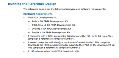

dsun01
New Contributor III
1,822 Views
if the auto created simulation environment doesn't work, it will be great to explicitly claim that in the AN708 to save some time for learner like me.
some designers like me always think Intel as a gold model. we will feel disappointed for any Non perfection. it is not Intel's problem at all.
Thank you,
David
Wincent_Altera
1,788 Views
Hi David,
I understand how you feel, I feel apologize for that.
As mentioned, there are multiple reasons why it is set to limit to hardware test.
(as FPGA could be very complicated sometime/somewhere)
But I believe, it is to provide customers with the most accurate test experience.
The requirement of running the reference design is stated in the AN708 user guide, page 10
I really apologize for any inconvenience caused to you.
For this case, my best help to you will be submit an internal ticket to request a simulation environment for AN708 design.
So that the designer know there is a need for this. Hope this helpful to you.
Wincent_Intel
