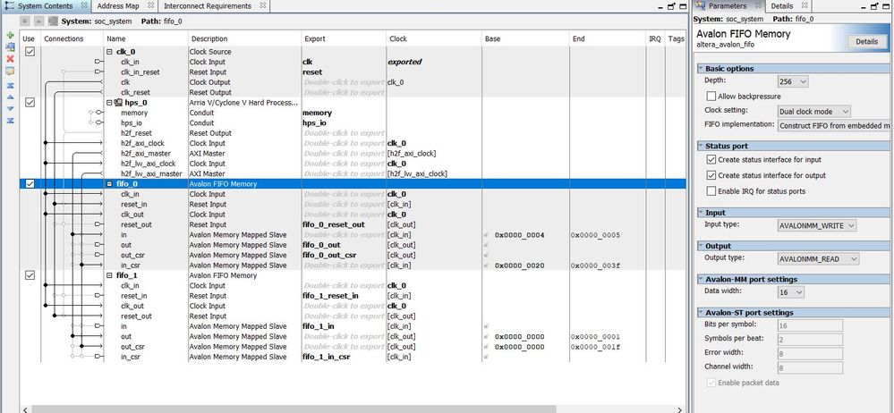

what is "fifo_out_csr_address" input in Avalon FIFO Memory ip?

Is there any possible screenshot of the system design that show that signal for better investigation
matif
1,020 Views
Here is the qsys system picture attached. and the module instantiation of qsys system. You can see (fifo_0_out_csr_address) and (fifo_1_in_csr_address). Just wana know what are these ports? and these are input ports.
module soc_system ( input wire [2:0] fifo_1_in_csr_address, // fifo_1_in_csr.address input wire [2:0] fifo_0_out_csr_address, // fifo_0_out_csr.address   input wire clk_clk, // clk.clk output wire [15:0] fifo_0_out_readdata, // fifo_0_out.readdata input wire fifo_0_out_read, // .read input wire fifo_0_out_csr_read, // .read input wire [31:0] fifo_0_out_csr_writedata, // .writedata input wire fifo_0_out_csr_write, // .write output wire [31:0] fifo_0_out_csr_readdata, // .readdata input wire fifo_0_reset_out_reset_n, // fifo_0_reset_out.reset_n input wire [15:0] fifo_1_in_writedata, // fifo_1_in.writedata input wire fifo_1_in_write, // .write input wire fifo_1_in_csr_read, // .read input wire [31:0] fifo_1_in_csr_writedata, // .writedata input wire fifo_1_in_csr_write, // .write output wire [31:0] fifo_1_in_csr_readdata, // .readdata input wire fifo_1_reset_in_reset_n, // fifo_1_reset_in.reset_n inout wire hps_io_hps_io_sdio_inst_CMD, // hps_io.hps_io_sdio_inst_CMD inout wire hps_io_hps_io_sdio_inst_D0, // .hps_io_sdio_inst_D0 inout wire hps_io_hps_io_sdio_inst_D1, // .hps_io_sdio_inst_D1 output wire hps_io_hps_io_sdio_inst_CLK, // .hps_io_sdio_inst_CLK inout wire hps_io_hps_io_sdio_inst_D2, // .hps_io_sdio_inst_D2 inout wire hps_io_hps_io_sdio_inst_D3, // .hps_io_sdio_inst_D3 inout wire hps_io_hps_io_usb1_inst_D0, // .hps_io_usb1_inst_D0 inout wire hps_io_hps_io_usb1_inst_D1, // .hps_io_usb1_inst_D1 inout wire hps_io_hps_io_usb1_inst_D2, // .hps_io_usb1_inst_D2 inout wire hps_io_hps_io_usb1_inst_D3, // .hps_io_usb1_inst_D3 inout wire hps_io_hps_io_usb1_inst_D4, // .hps_io_usb1_inst_D4 inout wire hps_io_hps_io_usb1_inst_D5, // .hps_io_usb1_inst_D5 inout wire hps_io_hps_io_usb1_inst_D6, // .hps_io_usb1_inst_D6 inout wire hps_io_hps_io_usb1_inst_D7, // .hps_io_usb1_inst_D7 input wire hps_io_hps_io_usb1_inst_CLK, // .hps_io_usb1_inst_CLK output wire hps_io_hps_io_usb1_inst_STP, // .hps_io_usb1_inst_STP input wire hps_io_hps_io_usb1_inst_DIR, // .hps_io_usb1_inst_DIR input wire hps_io_hps_io_usb1_inst_NXT, // .hps_io_usb1_inst_NXT input wire hps_io_hps_io_uart0_inst_RX, // .hps_io_uart0_inst_RX output wire hps_io_hps_io_uart0_inst_TX, // .hps_io_uart0_inst_TX output wire [14:0] memory_mem_a, // memory.mem_a output wire [2:0] memory_mem_ba, // .mem_ba output wire memory_mem_ck, // .mem_ck output wire memory_mem_ck_n, // .mem_ck_n output wire memory_mem_cke, // .mem_cke output wire memory_mem_cs_n, // .mem_cs_n output wire memory_mem_ras_n, // .mem_ras_n output wire memory_mem_cas_n, // .mem_cas_n output wire memory_mem_we_n, // .mem_we_n output wire memory_mem_reset_n, // .mem_reset_n inout wire [31:0] memory_mem_dq, // .mem_dq inout wire [3:0] memory_mem_dqs, // .mem_dqs inout wire [3:0] memory_mem_dqs_n, // .mem_dqs_n output wire memory_mem_odt, // .mem_odt output wire [3:0] memory_mem_dm, // .mem_dm input wire memory_oct_rzqin, // .oct_rzqin input wire reset_reset_n // reset.reset_n );

Hi Atif,
That port is an interface of avalon-mm slave that can be used to implement read and write interfaces for master and slave components. The following are examples of components that typically include memory-mapped interfaces and in your case is avalon fifo memory.
