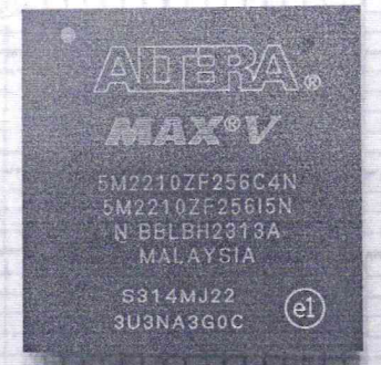

I really need your help with part number 5M2210ZF256I5N.
What solder ball alloy composition is acceptable if the original documentation specifies Sn 96.5%, Ag 3%, Cu 0.5%?

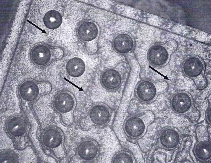

This question concerns the composition of the solder balls. The documentation specifies 96.5% Sn, 3% Ag, and 0.5% Cu.
Could you please clarify what deviations in composition are acceptable?
Also, please take a look at the attached photos — there are scratches under the BGA balls and signs of cleaning or abrasion.
Is this considered normal?
Can the surface become scratched like this during the manufacturing process?

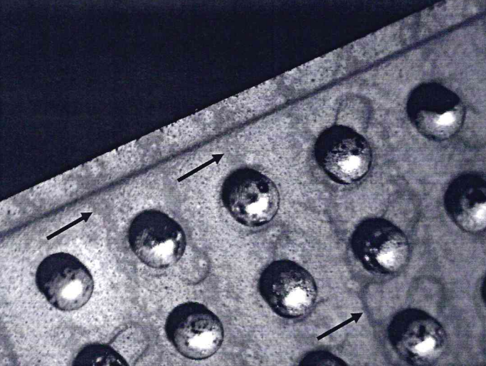

I will attach several numbered photos showing different defects on the solder mask of these components. Please have a look — I believe the defects are not critical and could have occurred during manufacturing.
1. Slight deformation of the solder balls, presumably due to long-term storage — I believe it should not affect soldering.
2. Inclusions under the mask — it seems the surface may not have been properly cleaned from dust before the mask was applied.
3. A strange inclusion on the mask, as if a second layer — it's not near the solder balls. What could this be?
4.1, 4.2, and 4.3: Abrasions on the mask — could such marks remain from cleaning during production, and are they acceptable?
5.1, 5.2, and 5.3: Scratches of varying lengths passing under several solder balls. They are shallow, and the mask is not scratched through — are such minor scratches acceptable?
I would really appreciate your help in evaluating these!

I have forwarded the photo and questions to our quality team for review.
Will update you once I have the answer.
Aiman
Update from our quality team,
Below are the existing criteria.
While some of these units may fail the criteria, specifically the scratches, we have not had any history of validated failures associated with surface scratches such as what is seen on these images.
Substrate scratches:
- Reject scratch greater than 80 mils (~2mm) in any direction.
Solder ball criteria:
- Visible damage at 1x magnification (naked eye or unaided human vision inspection) that leads to out of spec ball height.
- Reject if any foreign material is found on solder balls with length greater than half the ball diameter.
- Reject for any visible misalignment (against the pad) at 1x magnification (naked eye or unaided human vision inspection).

As mention, we have not had any history of validated failures associated with surface scratches such as what is seen on these images.
However, if your device does not meet the criteria that was listed in my previous response, then they are good to go.
Aiman
Some of the scratches actually go across multiple balls, but they don’t look like reballing marks.
