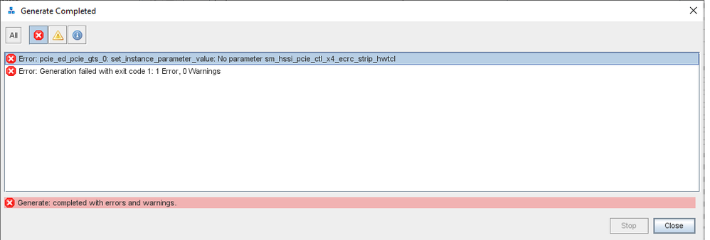

I ran the pcie_ed project and opened Platform Designer to generate the code. During this process, I get the following error:
Error: pcie_ed_pcie_gts_0: set_instance_parameter_value: No parameter sm_hssi_pcie_ctl_x4_ecrc_strip_hwtcl
I didn’t change anything in the project.
I also created a new project and added the “GTS AXI Streaming Intel FPGA IP for PCI Express” IP core, and I’m getting the same error there as well.
How can I fix this, and what does this error refer to?

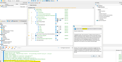

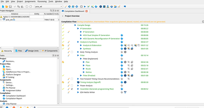

Hi Robert,
I try to download the from the same link as yours and run full compilation in Quartus v24.3.1.
the compilation PASS 100 % without any error.
Another method you may try is to generate from our IP catalog, you may refer the step in 2.2. Generating the Design Example
  • I try to compile the same in IP catalog, the result was passing as well, attach the design .qar file as per your reference purpose

Thanks a lot for the info and help. It turned out the issue was on Quartus’ or Windows’ side – I solved the problem last night.
Specifically, on a clean Windows installation, I installed Quartus 24.3.1, and synthesis completed successfully without any errors. So I started looking for the issue on my PC.
Since we have different projects, we also use different versions of Quartus, namely 13.0, 18.1, 21, 22, and the latest 24. I checked the Windows PATH, and it pointed to the newest version.
However, I began removing older versions from the system one by one, and only after removing version 21 did the synthesis finally go through correctly in version 24.3.1.
Apparently, some references were assigned to a path they shouldn’t have been.
The main thing is that the problem is solved. Thanks again for your help!

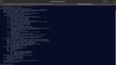

From the Ubuntu side, I checked:
robert@robert-Z590:~$ lspci -d 1172:
02:00.0 Unassigned class [ff00]: Altera Corporation Device 0000 (rev 01)
LnkCap:	Port #1, Speed 8GT/s, Width x4, ASPM L0s L1, Exit Latency L0s unlimited, L1 unlimited
		ClockPM- Surprise- LLActRep- BwNot- ASPMOptComp+
LnkSta:	Speed 8GT/s (ok), Width x4 (ok)
		TrErr- Train- SlotClk+ DLActive- BWMgmt- ABWMgmt-
So the link between the device and the computer exists – but there is still a problem with reading and writing.

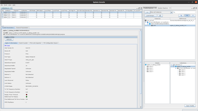

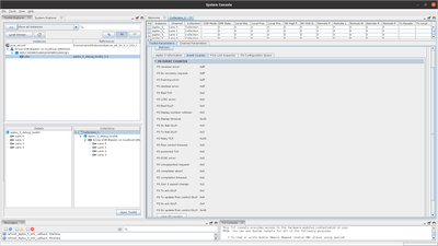

I enabled the debug toolkit and got the following results:
Do you have any idea where the issue or error might be?
Wincent_Altera
1,946 Views
Hi Robert,
It seen unusual to me that from your lspci command, it seen like the speed and width is in expected way.
However, the debug toolkit show it stuck at recovery_rcvrlock.. Is this happen during the transition or before the transition ?

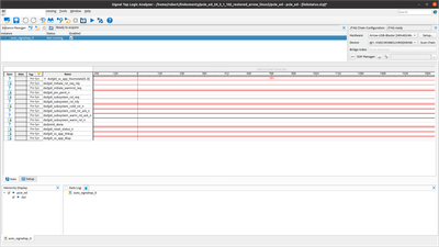

As I mentioned in my previous message – the system sees the device and has theoretically negotiated the link. Below is also a screenshot from SignalTap:
I'm also including the "Event Counter" tab from the console:
To be honest, I’m not sure where the issue is.

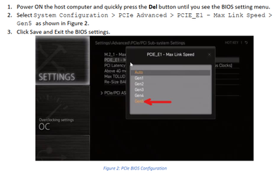

  1. is it possible to try in another host ? see if the issue is following or not, so that we can narrow down either is fpga issue or host issue.
  2. Do you configure your Host setting ? normally the host setting by default will be "AUTO" for PCIe sides
    I ever experience certain type of host is unable to direct negotiated the speed which causing link up problem.
    Please try to set into your desired speed based on design instead of using "Auto"

When I initially saw in your documentation that there was information about changing the BIOS setting from “AUTO” to the appropriate standard, I changed it immediately, but unfortunately I got the same error.
