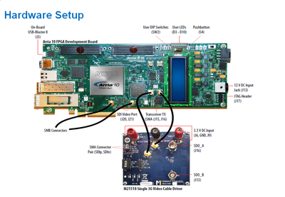

Hardware Setup
9/9d/Hardware_Setup.PNG
( Hardware Setup.PNG - click here to view image )
 1. For demonstration on feature of SDI II Tx Dynamic Switching (Channel 1) :
  • Power up M21518 single 3G cable driver with 3.3V DC voltage source
  • Connect Transceiver Tx(J15,J16) to SMA connector pairs( SDIp,SDIn) of M21518 single 3G cable driver by using SMA cables
2. For the demonstration on SDI II receiver (Channel 0), you can either :
  • Connect the transmitter output, SDO_A(J16) of channel 1 to the receiver input, SDI_RX_P(J20) of Channel 0
  • Connect an external SDI signal generator to the receiver input, SDI_RX_P(J20) of Channel 0.

1. Set up the hardware as shown at above.
2. Ensure the board setting DIP switches on the development kit are set correctly. Refer to a10-sdi-tx-refclk-dynamic-switching-dipsw-led-pb.docx for more details on this.
