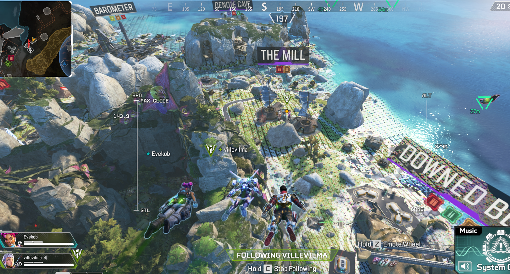

Hello, I’m experiencing a graphics issue in Apex Legends where:
  1. Ground textures never load correctly and always appear extremely low-resolution, blocky, or corrupted. This happens throughout the entire match, not just when viewing from the dropship.(See screenshot(The screenshot was taken from another discussion.))
  2. A recent update introduced a snow problem on one of the maps (Since you have a size limitation, here is a link to the video of the second point: https://drive.google.com/file/d/1maCzoxXX_1Sbp3xy9d4OMMvU3biOjl3_/view?usp=sharing)
  3. I've been struggling with the first point for a year now, but I've almost gotten used to it, but another 2nd point has appeared.

  • Ground textures (grass, dirt, farmland, etc.) appear pixelated, blotchy, and low-detail at all times, even when standing right on them.
  • Textures do not seem to properly load into high resolution, despite sufficient VRAM and system RAM.
  • Other games on the same hardware display textures normally, so this seems isolated to Apex Legends.
  • On the other map, I understand that the reflection on the snow is very bad, or there is a problem with the lighting (I don’t really understand)

2026-02-15 20_32_35-Apex Legends.pngFor me the same. Before I had only problems at Storm Point:

Sorry, I didn't send a screenshot of the problem in point 1. Here it is.
OrixoN
9,041 Views
Details on this issue: when I get closer, these squares disappear.

Dear Arc B580 users,
I would like to thank everyone in the community for your support and shared feedback. I am also an Arc B580 user, and I, too, have been deeply plagued by this exact issue for a long time.
I want to share some good news: I have already escalated this issue directly to the Intel Engineering team via a formal support ticket (Case ID: 06819152).
The engineering team has officially acknowledged this as a known driver-level rendering problem affecting the Arc B580 community. They are currently investigating it as a priority for an upcoming driver fix.
To provide transparency on their progress, the team has finally published an official Knowledge Base (KB) article regarding these specific texture and scenery issues (updated on March 23th)
 https://www.intel.com/content/www/us/en/support/articles/000101933/graphics.html
Therefore, Intel engineers already have all the data and logs they need, and the issue is officially documented.
Please refer to the KB article, hang tight, and let's wait for the upcoming driver update. A real fix is actively in the works!
