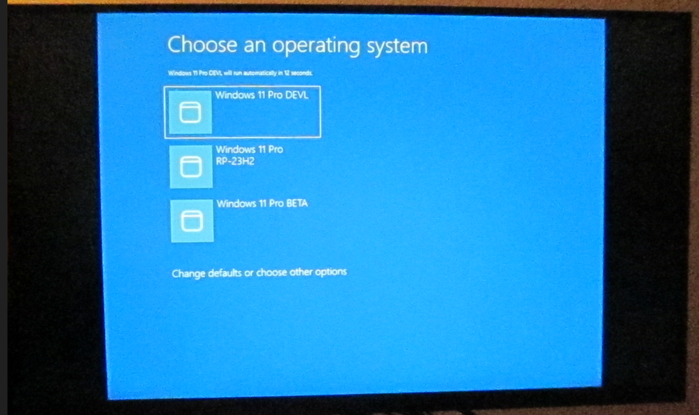

FGG2001
16,185 Views
Driver 31.0.101.5379 worked for me too, I got my Boot screen back, even if it is not filling the whole screen.
In this test my screen is connected to a Display Port on the Intel UHD Graphics 750.
I can now boot and get up to the System that I select and work properly with Windows of different Builds.
If I put Dev Build 26085.1 as default boot, the boot window is not filling up the screen, but with the Beta Build 22635.3350 and the Release Preview Build 22631.3296 the boot menu fills the whole screen normally.
Looks like they still have a problem with Windows Dev and Canary Builds 100% compatibility.
